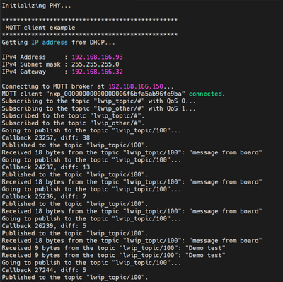

Below is my testing result, in general, the board receives the puback in 50 ms from the broker after publishing the message data.
However, I don't find the Publish Ack in the 103.txt, in another word, the mqtt_message_published_cb won't be called.

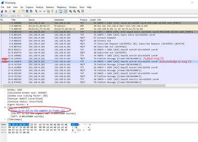

Frame 14 is an Ack to frame 13, which is a regular publish message. The log contains lots of Acks like frame 14. Please find a new attachment (103.pcapng) which is the same log as 103.txt, but this file can be opened in Wireshark, you'll see the Ack messages.
Great to see that you have the same results, the publish callback is called within 50ms, that's what I see too, except when using the industrial PC, the time to callback is than increased to 200ms, that's what worries me, how could such a delay occur?

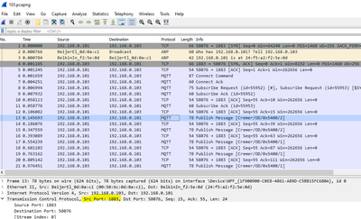

I don't really understand what you mean, all publish messages and acknowledges can be seen in the log, I illustrated one publish and Ack in the attached screenshot.

In the 103.pcapng, the board doesn't publish the message to the PC: 1883 port.

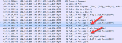

Further, according to the MQTT protocol, the client or broker receives the message, it will respond the Publish ACK (like the below figure shows), it also doesn't exist in the 103.pcapng too.

If you look in the detail window, you'll see that port 1883 is used by the board, Wireshark also recognizes this and marks it as an MQTT message:

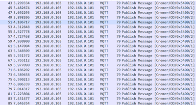

I think you'd better read my reply carefully, I see the Wireshark recognize the Publish message whose direction is from the broker to client, however, 103.pcapng doesn't have the Publish message whose direction is from the client to broker, that's the key point.

Do you perhaps have some filter applied in Wireshark? As you can see in my screenshot, which is from file 103.pcapng, messages are sent from 192.168.0.101 (the board) to 192.168.0.103 (broker) and vice versa.
