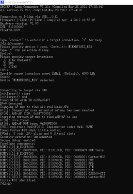

5,900件の閲覧回数
kerryzhou
Hi @sergei_pilipenko
  Which detail project you are testing in the SDK? SDK_2.9.0_EVK-MIMXRT685\boards\evkmimxrt685\dsp_examples
If the xaf_demo, that project really build with long time, but you mentioned, the EVK board is OK.
So, I don't know whether you are testing this project or not?
When you use the external LPC-LINK2 with your own board, do you modify the topology.xml in folder:
C:\Program Files (x86)\Tensilica\Xtensa OCD Daemon 14.01
As the EVK JLINK serial number should not the same as your LPC-LINK2 jlink firmware.
About the EVK connect to external LPC-LINk2, SWD connect to J2, USB connect to J6, not J5. then you can use the external LPC-LINK2 as the debugger, this is the external LPC-LINK2 with JLINK result, you can find it can find the ARM core, it means external debugger is OK to use:
Please use your external JLINK connect to the EVK, whether it is the same as your customer board or not?
Kerry
