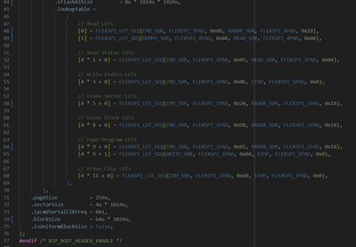

The external flash I use is different from the eval-board external flash. For this reason, I need to change the settings in the flexspi_nor_config file. Can you give me flexspi_nor_config.c configurations or documentation that explains how to configure according to my external flash?

  • I made some edits to the Flexspi_nor_config.c file; I activated QEN and set serialclkfreq to 50mhz.
  • I set the gpio to FLEXSPI INSTANCE 2. I set the FLEXSPI_PIN_GROUP_SEL bit of the 0x9a0 flexspi nor efuse and burnt it.
  • I defined XIP_BOOT_HEADER_ENABLE=1.
  • I updated the flash base addresses in the linker to start from 0x60000000.
  • I am working in internal boot mode.
In this case, I expect it to work in XIP mode and now I can debug it.
But my current problem is that when I turn the power of my microcontroller off and on, my code does not run. I observed it with the debug LED I put in the code.
I think the problem here may be that it goes into serial downloader mode due to an error during the rom bootloader.
What should I check or is there a fuse I should use or a flexspi configuration I should change?
