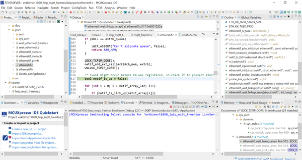

Kan_Li
Hi @ping1 ,
Thanks for the clarification! I just tried to debug lwip_mqtt_freertos demo on RT1050EVKB, the debug is fine as shown below.
Have you ever try such demo on your own board?  was the problem still there? Please kindly clarify.
Kan
