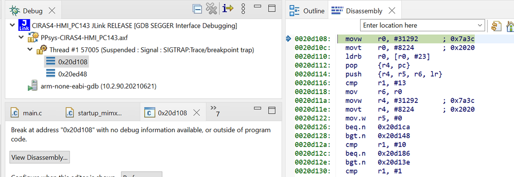

 My application locks up and Debug shows it in various 0x2xxxxx addresses as seen below.
I have a watchdog, which never triggers. And a HardFault_Handler() and BusFault_Handler defined which never gets hit either. Nor are the fault registers showing anything. DWT continues to count up and PC continues to move. So I'm a bit confused what is going on.
ITC is from 0x0 to 0x20000. So it's not in there. Is 0x20d108 anything?

Hrm, it's spinning its wheels in BootROM on XIP flash boards. But on generic QSPI flash it reboots. I assume that's because the CPU Lockup reset sequence doesn't provide the needed JEDEC reset sequence XIP flash needs? I don't suppose there's a way for CPU Lockup reset to reset XIP as well is there?
Regardless, is there a way I can customize what happens with CPU Lockup? I'd like the watchdog to always handle everything.

SRC->SRSR = 0x2. I.e., the lockup_sysresetreq bit is set.
How can I more properly handle when that happens?

Oh, its BootROM.  So how/why would an application jump there? And how do I guard against this? As it's overriding my Watchdog.
