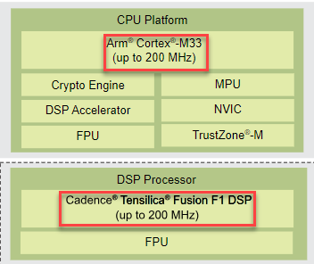

Habib_MS
Hello again @adc_6_6,
Does not exist a particular specification that you have be careful. Only remember that the maximum clock frequency of both is 200MHz, as shown the next diagram:
