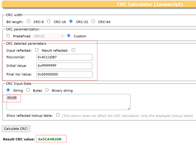

I've came a little bit further. DCP / CRC32 indeed calculates a CRC of "CRC-32/MPEG-2" (thanks for the input there @MultipleMonomials !), but... it ONLY does that, when I supply an input which has a length % 4 == 0.
So for the input string "aaaa" it calculates 0x77EDCC59 which matches perfectly with the algo online
We can repeat this with any string, as long as the length is a factor of 4.
Can you help explaining why a random length fails? Is this a bug in the DCP driver? Or does this go wrong in hardware?

mayliu1
Dear @bp1979 ,
Dear bp1979, Thanks for your replay.
I do a validation for input different length of CRC32.
I use  a CRC32 checksum URL for comparison.
1:  If I input string length is multiple of 4, the result is same.
2: If I input “abcde”,length is 5,NXP DCP CRC32 calculate  the result is different from Web .
I will submit a request ticket  for support from the relevant module owner.
Please keep patience, Thanks very much.

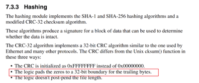

mayliu1
Hi @bp1979 ,
Thanks for your patience.
In the Security Reference Manual for the i.MX RT102X Processor, It describe as following Fig.
If user data is not 4bytes-aligned, HW will pad it with zeros.
So it is not a bug,  SRM have describe this.
Wish it helps you.
Best Regards
mayliu
