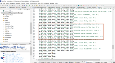

After this works, then you can modify the dcd.c:
Mainly fill the SDRAMCRn register to the data which you tested in the above semc_cm7 demo.
You can try it on your side.
If you still have a question about it, please kindly let me know.
Wish it helps you!

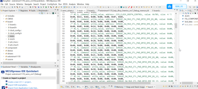

hi @kerryzhou,
How can I change pins on dcd file? Because evk has 2 SDRAM and I must close SEMC A12 and SEMC_D16 to SEMC_D31.
1,902 Views
kerryzhou
Hi @tbayram ,
In the first area of the DCD.c, it is the SEMC pin control:
Wish it helps you!
