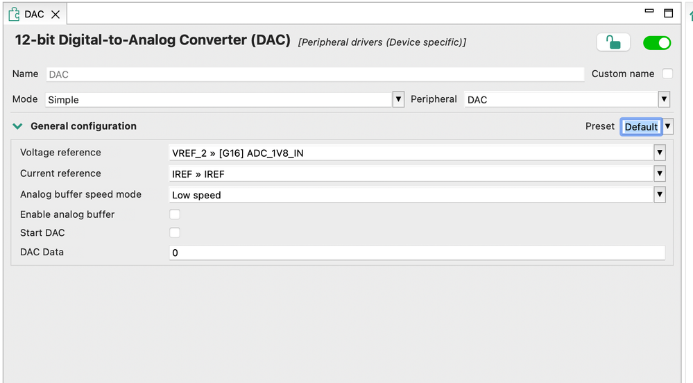

We're trying to implement DAC0 DMA procedure with iMXRT1170-EVK. Reference manual states that DMA is supported but peripheral tool does not have such options:

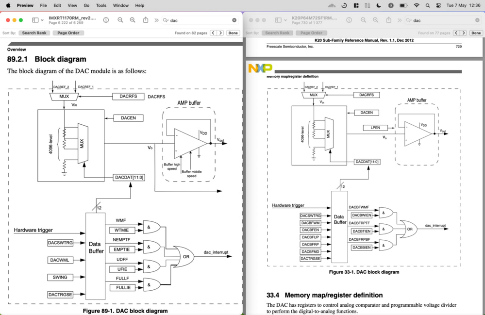

We've noticed there's no example project in SDK with DAC0, so we tried to port it from K20 family. The functional diagram is very similar, however register maps differs.

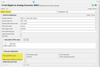

DMA is supported in Buffered mode:
Regarding the comparison of the RT1170 DAC with the Kinetis DAC, at high level approach both modules seem similar, but the peripherals are not exactly the same.
And sorry for the inconvenience but there is no DAC-DMA example available for RTs.
