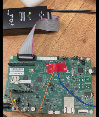

corentinalleard
I have a custom Board (inspired by the demoboard).
That's right, I use a Jlink with a 6-pin adapter (like this https://www.segger.com/products/debug-probes/j-link/accessories/adapters/6-pin-needle-adapter/).
I then respected the pinout on my board (except for the SWO, which arrives on the ground because I don't use it).
I checked (and compared with the demoboard) the SWDIO, SWDCLK and RST signals on the oscilloscope.
They're consistent. Obviously, the end is not the same, since there's a problem with my board.
Do you have an idea ?
Corentin

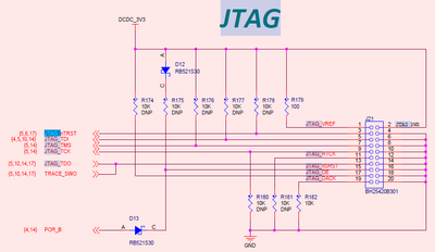

Attached is my schematic. We added a pull down on JTAG_MOD ( GPIO1_IO08)
We notice a problem during flashing, the SWDIO quiescent voltage is high and SWDIO starts talking in 3V3 then goes to 1V7.
6,882 Views
Pavel_Hernandez
Hello, I recommend opening an internal case, to check the schematic, tagging my name in the new case.
