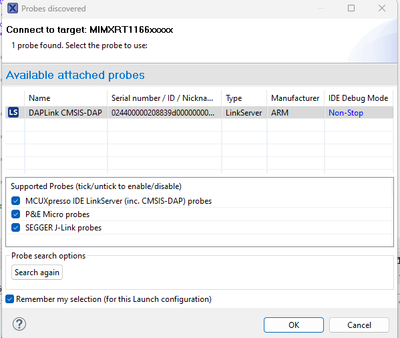

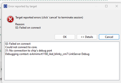

Hello Team,
I am using iMXRT1160 EVK for my project and I imported the SDK examples.
I have built the application successfully, but i am facing issue while debugging the application.
Attached the reference issue given below

Can you please help me with this first steps:
  1. Can you please delete the .launch file in the project and re-created by click on the blue debugger.
  2. Also it is possible give a look into yor device manager to see if it is been detected properly (also try to change the port hub) and please check the firewall settings.
Please let me know this in order to find a solution to your case.
