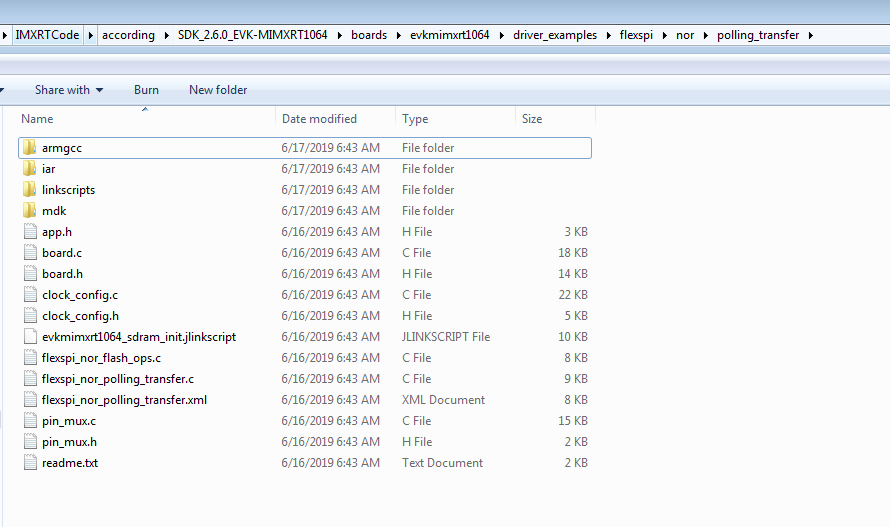

Hi Paul Roberts,
   Thanks for your detail reply, the IDE version and the new SDK compatibility is really need to improve.
   I checked the SDK2.6.0,
    It also contains the evkmimxrt1064_flexspi_nor_polling_transfer project, do you mean, you also can't run this version code on your MCUXPresso 10.3? You said you get: which suggests that my J-Link software needs to be updated.
Could you give me a screenshot about it?
   If you install the newest JLINK driver, still can't work? What's the detail problem, any picture about it?
   To be honest, I even delete the MCUXpresso 10.3 for a so long time. But I would like to help you to analyse your question together.
