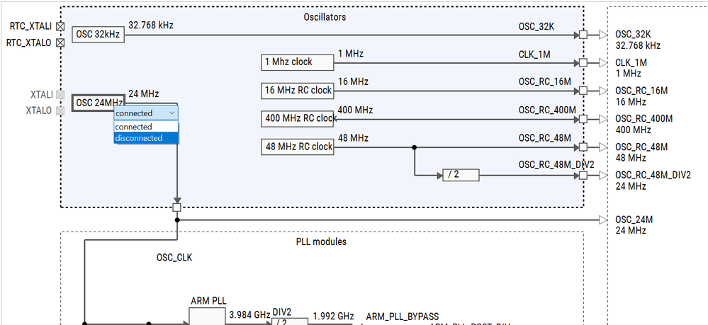

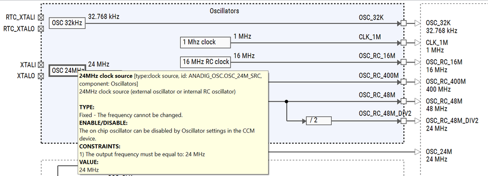

aberger
Senior Contributor I
Hmm, the Clocks Tool seems to imply that the OSC 24 MHz can be an "internal RC oscillator".
Meanwhile, the RM refers to the 24 MHz as a crystal oscillator available on the chip:
Regardless of whether it as an RC oscillator or a XTAL oscillator, is there a source of 24 MHz available "on chip" (i.e. without an external connection to a XTAL or reference clock)?
If I set the Clocks Tool to "OSC 24 MHz disabled", the XTALI and XTALO pins become disabled, but there still appears to be a 24 MHz signal coming out of the Oscillators block (which suggests on on-chip source of 24 MHz). Only if I click on the OSC 24MHz and select "disconnected" does the OSC 24MHz block get labeled as Inactive.

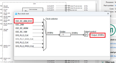

marek_neuzil
Hello @aberger,
I have checked the usage of the internal RC oscillator 48 MHz (divided by 2) as 24 MHz clock source. This 48 MHz internal RC oscillator (divided by 2) can be just used as a clock source in the CCM clock roots, see the clock diagram below:
It can be used for peripherals and also CPU cores but this internal RC oscillator cannot be used for PLLs as it is visible in the clock diagram in the Clocks tool. The internal RC oscillator is not precise and stable to be used as a clock source for PLLs.
The only possible clock source for all PLLs is an external crystal or external oscillator. Please, ignore the confusing comment of the OSC 24 MHz clock element in the Clocks tool for the MIMXRT1176 MCU (it will be removed).
Thus, if you want to use the internal 48 MHz RC oscillator, all PLLs must be disabled and the  internal 48 MHz RC oscillator clock source must be selected in the CCM (clock roots) . But still the recommendation is to use the external oscillator to have better stability in clocks.
Marek Neuzil
