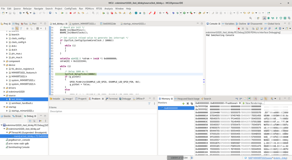

The SDRAM seems to work OK at this point. Then, when we want to create a DCD for the ROM to initialize the SDRAM to use it as main memory (stack + heap + .data + .bss) we get a Hard Fault on startup (before main function). I attached the DCD we used. The following screenshot is the point before a Hard Fault is triggered

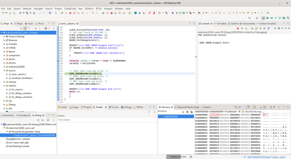

Using the "Memory" window when we write the value 0x11223344 at address 0x80_000_000 and initialize the SEMC inside the main function in ""evkmimxrt1020_semc"" example we see that it is written correctly.
When we do the same using DCD configuration we can clearly see that it is not written correctly. (Look at adress 0x80_000_000 in memory window)

Hello @gtalocchino again,
      Since the CAS Latency you set is 2. So the mode register should be 0x20 in the dcd.c file.
 /* #7.1, command: write_value, address: SEMC_IPTXDAT, value: 0x20, size: 4 */
0x40, 0x2F, 0x00, 0xA0, 0x00, 0x00, 0x00, 0x20,
      So in your dcd.c file the SEMC_SDRAMCR3 register and SEMC_IPCMD register should be changed.
      You can try it and re-upload your dcd.c file if it still doesn't work.

tongtong_zhai
Hello @gtalocchino ,
   The sdramconfig.refreshPeriod_nsPerRow set in BOARD_InitSEMC() function you provided should be
   sdramconfig.refreshPeriod_nsPerRow = 64 * 1000000 / 4096; /* 64ms/4096 */ .
  Since the  number of rows is 4096 in the type of chip you provide. So dcd.c should also be changed accordingly.

gtalocchino
Hi @tongtong_zhai
Yes, that was the problem! Changing the value set in IPTXDAT from 0x30 to 0x20 (due to CAS latency = 2 selected) solved the problem. Now it works correctly. We modified also the DCD according to the number of rows of our SDRAM is 4096.
