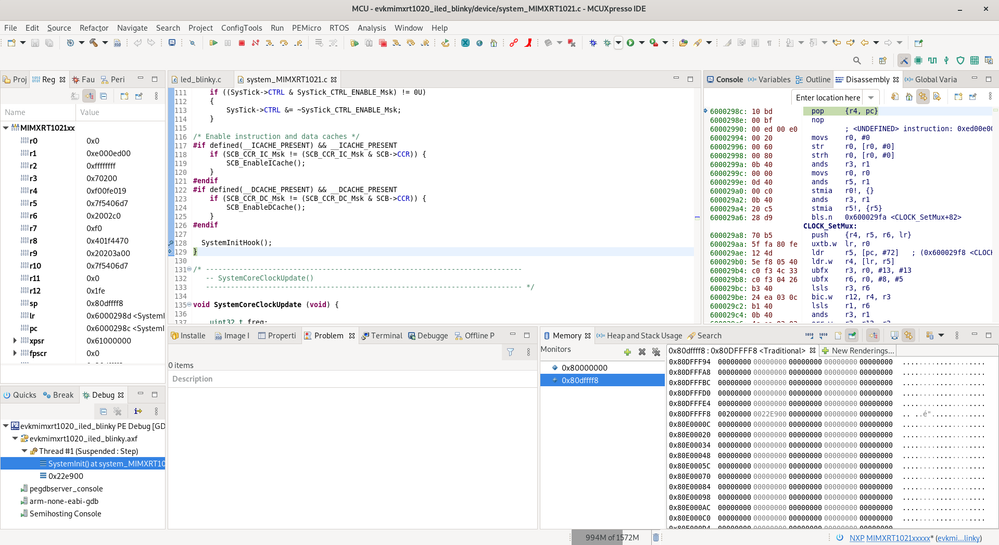

The SDRAM seems to work OK at this point. Then, when we want to create a DCD for the ROM to initialize the SDRAM to use it as main memory (stack + heap + .data + .bss) we get a Hard Fault on startup (before main function). I attached the DCD we used. The following screenshot is the point before a Hard Fault is triggered
Using the "Memory" window when we write the value 0x11223344 at address 0x80_000_000 and initialize the SEMC inside the main function in ""evkmimxrt1020_semc"" example we see that it is written correctly.
When we do the same using DCD configuration we can clearly see that it is not written correctly. (Look at adress 0x80_000_000 in memory window)
We have reviewed the DCD over and over again. Is there anything we are not considering?

Hello @gtalocchino again,
      Since the CAS Latency you set is 2. So the mode register should be 0x20 in the dcd.c file.
 /* #7.1, command: write_value, address: SEMC_IPTXDAT, value: 0x20, size: 4 */
0x40, 0x2F, 0x00, 0xA0, 0x00, 0x00, 0x00, 0x20,
      So in your dcd.c file the SEMC_SDRAMCR3 register and SEMC_IPCMD register should be changed.
      You can try it and re-upload your dcd.c file if it still doesn't work.

gtalocchino
Hi @tongtong_zhai
Yes, that was the problem! Changing the value set in IPTXDAT from 0x30 to 0x20 (due to CAS latency = 2 selected) solved the problem. Now it works correctly. We modified also the DCD according to the number of rows of our SDRAM is 4096.

Firstly, I'd like to know whether you ever modify the DCD to fit the SDRAM on the custom board, next, please use the hello_world demo for testing, as this demo default uses the SDRAM as the primary RAM, which means you almost don't need to change the memory configuration and MPU setting.
TIC
10,442 次查看
gtalocchino
Hi Jeremy, thank you for your response. We have tried the hello world example you mentioned. We get the same error. In the first image you can see that the Hard Fault occurs when running pop {r4, pc}. If you look at the memory window at the bottom right you can see that the stack pointer retrieves from memory a value for the PC that is not in the valid range of the FLASH. This implies that the previous push operations failed (SEMC is not writing the memory properly).
And yes, we have modified the DCD to configure the registers BR0, IOCR, SDRAM0, SDRAM1, SDRAM2, SDRAM3, IPCR1, IPCR2, etc... according to the configuration required by SDRAM datasheet tested successfully with "evkmimxrt1020_semc" example. You can check this in the dcd.c I attached.
