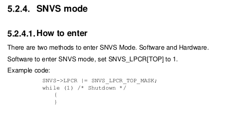

I need to use the SNVS mode. As i mentioned in the previous thread, I tried entering the SNVS mode as mentioned in the Application Note (as shown below):
After this when i give a low signal to the WAKEUP pin, it should wake the target right?
But this is not happening in my case. I wanted to know whether there is any additional changes to be made in order to wake up the device from SNVS mode. Could you please help me with that?

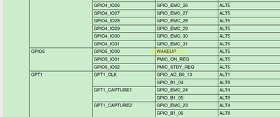

dashdwan
I have used the L6 pin (GPIO5) as wakeup pin:
I am implementing an LED blink function like the code snippet shown below.

if you are not use the above code, you need to make sure the wakeup pin configuration in the pin_mux.c
/* GPIO configuration of SD_PWREN on WAKEUP (pin L6) */
gpio_pin_config_t SD_PWREN_config = {
.direction = kGPIO_DigitalInput,
.outputLogic = 0U,
.interruptMode = kGPIO_IntRisingEdge
/* Initialize GPIO functionality on WAKEUP (pin L6) */
GPIO_PinInit(GPIO5, 0U, &SD_PWREN_config);
/* Enable GPIO pin interrupt on WAKEUP (pin L6) */
GPIO_PortEnableInterrupts(GPIO5, 1U << 0U);
IOMUXC_SetPinMux(IOMUXC_SNVS_WAKEUP_GPIO5_IO00, 0U);

Thanks a lot! This code worked for me. But i have 2 queries on this:
  1. I suspect, on waking up, does the program restart from main function itself? It doesn't seem to resume from the same point where it was sent to SNVS mode. What do you think about this?
  2. Could you please elaborate what were those changes made by you in the code to get this wake up? I'd just like to know why it wasn't working for me. Is there any functions to be added or any other configuration changes?
2,849件の閲覧回数
kerryzhou
Hi  @dashdwan
Answer your questions:
1 I suspect, on waking up, does the program restart from main function itself? It doesn't seem to resume from the same point where it was sent to SNVS mode. What do you think about this?
- Answer:  Yes, the SNVS mode wake is the reset boot. It's correct. if you need to resume from the low power enter area, you need to use other low power mode instead of the SNVS mode.
