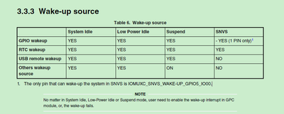

  Please note, WAKEUP pin is the special pin, not the GPIO pin. You may mix the pin which can wake up the low power with the WAKEUP pin.
  Please read this RT1060 low power application note at first:
https://www.nxp.com/docs/en/application-note/AN12245.pdf
So, please check the low power mode you want to use, if you use system idle, low power idle, suspend these low power mode, you add the other GPIO for the interrupt, it's OK to wake up the low power.
But, if you want to use the SNVS, then you just can use the special WAKEUP PIN, GPIO5_IO00, no other GPIO pins.

I need to use the SNVS mode. As i mentioned in the previous thread, I tried entering the SNVS mode as mentioned in the Application Note (as shown below):
After this when i give a low signal to the WAKEUP pin, it should wake the target right?
But this is not happening in my case. I wanted to know whether there is any additional changes to be made in order to wake up the device from SNVS mode. Could you please help me with that?

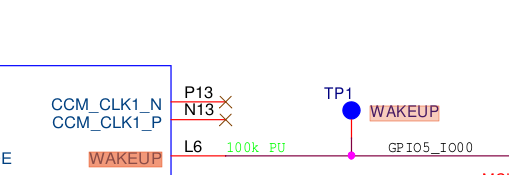

 Tell me which detail pin in the SLN-LOCAL2-IOT hardware you used as the WAKEUP pin, just help you to check it.
  BTW, how do you determine the chip is not waked up.
Kerry
4,456 Views
dashdwan
I have used the L6 pin (GPIO5) as wakeup pin:

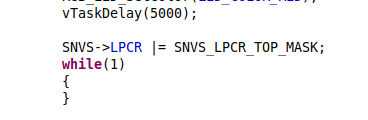

I am implementing an LED blink function like the code snippet shown below.
void led_task(void *arg)
while(1)
RGB_LED_SetColor(LED_COLOR_GREEN);
vTaskDelay(3000);
RGB_LED_SetColor(LED_COLOR_PURPLE);
vTaskDelay(3000);
RGB_LED_SetColor(LED_COLOR_YELLOW);
vTaskDelay(3000);
RGB_LED_SetColor(LED_COLOR_WHITE);
vTaskDelay(3000);
RGB_LED_SetColor(LED_COLOR_RED);
vTaskDelay(5000);
SNVS->LPCR |= SNVS_LPCR_TOP_MASK;
while(1)
I tested with this code, the system stops the LED blinking, but doesn't start again after initiating the wakeup.
