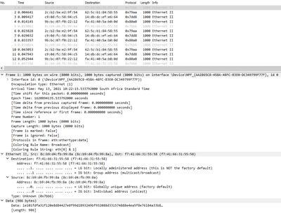

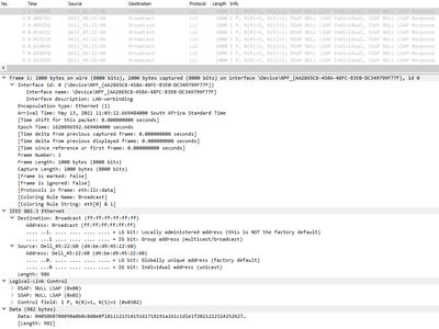

Another update (@FelipeGarcia):
I captured some packets using Wireshark to see if my project is indeed not transmitting.
To my surprise, it was transmitting, but the data is just completely jumped. This is extremely strange though, since the jumbled packets seem to repeat themselves every 4 packets.
I checked the contents of the frame (in the software) before it is transmitted, and it is correct.
Here is a screenshot (I can't upload the .pcapng) of the packets received from my project:
and a screenshot of the packets received from the example project:
The frames captured should be equivalent when my project is working correctly.
If anyone could share why the Ethernet data would be jumbled like this, it would be much appreciated.

I realised that the repetition every 4 packets is not a coincidence.
My TX & RX buffer size in the code was 4 frames.
When I increased the buffer sizes to 5, the packet contents was repeated every 5 frames.
As a result, I am confident that my problem is to do with how the data is copied into this buffer.
Any help would be appreciated.
