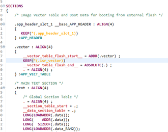

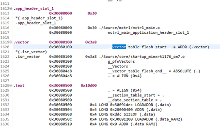

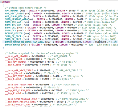

The table needs to be placed at 0x30080100 in the external SPI flash. The linker files have been modified accordingly and the map file looks good. Below are a few screenshots:

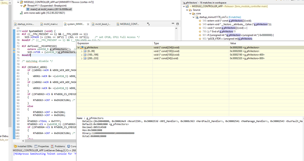

 - When debugging the vector table appears at 0x30002000, not at the address intended.
 - The binary also appears to be different. Probably something else to figure out. It does not match what is expected based on the map file, or the memory observed while debugging.

What I failed to realize is that the debugger configuration was not configured to work with the active configuration for the project...    Meaning, it was always working with the Debug configuration even though the project was actively configured with the Release one, and that is why nothing matched and nothing made sense.
Now the memory, the binary, and the map are aligned and I can start my weekend with a happy face.
