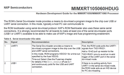

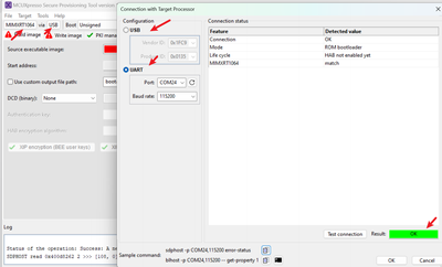

So I suggest you can use SEC Tool to boot the RT1064. If the RT1064 board can connect with PC by LPUART1 or USB1, it means the RT1064 chip work well, then we can continue find root cause.
https://www.nxp.com/design/design-center/software/development-software/mcuxpresso-software-and-tools...
1: set RT1064 board as serial downloader mode.
2:open SEC Tool, create a new workspace about RT1064
3: connect by LPUART1 or USB(depend on your bard design)
Please try it.
