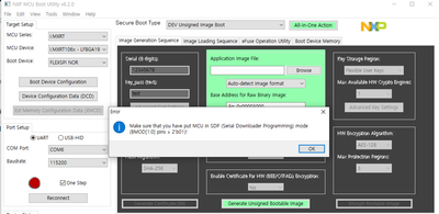

I'm try to use NXP-MCUBootUtility. but it doesn't work. I can't connect..

kerryzhou
Hi @yelin ,
 Thanks for your updated information.
1. J61 remove 1-2, connect 2-3.
2. Power off and power on the board again
3. the MCUbootutility use the USB, then you will can find USB PID/VID.
Then try to connect it again on your side.
Click connect to ROM, then you will find it is connected:
Wish it helps you!
Kerry
3,507件の閲覧回数
yelin
I tried that, but the process bar didn't go any further at 80%.
3,355件の閲覧回数
kerryzhou
Hi @yelin ,
  That's strange.
  You can find the USB PID/VID, right? Just can't download it?
  What's the boot device config you are using now? In fact, default is OK.
  If you still can't make it work, seems you board meet issues, as I share you the screenshot just from my own SLN-SVUT-IOT board.
Kerry
