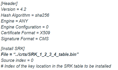

I'm using the CST tool to encrypt the image and trying to use the HAB API to decrypt that
However, I found the CST tool needs to reference the CSF file.
The CSF file describes the SRK information and certificate.
but when I run the CST tool to generate csf.bin. The size is around 7K always.
Is there any idea to reduce the bin.csf file size?

Casper
Hi @kerryzhou ,
Thanks for the csf.bin provided.
May I know how you generate the csf.bin?
Thank you.
As far as I know, the csf data should include the SRK and other information below

4,000 Views
Casper
I found the root cause was the SRK file.
The SRK bin size will affect the generated csf.bin size.
