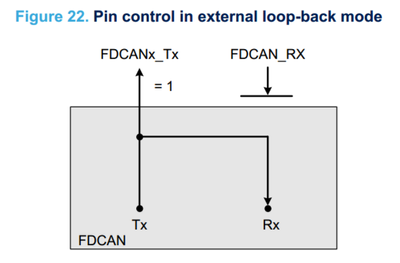

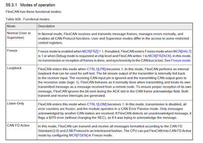

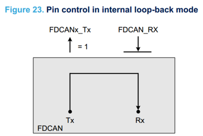

Gavin_Jia
Hi @vilas_shetty ,
Thanks for your interest in NXP MIMXRT series!
RT1180 FlexCAN provides these operation modes:
This loopback mode is what you call internal loopback mode, which is used for self-testing, but in this mode the Tx and Rx pins are not able to detect any external signals.
In the meantime, I've checked other sources and found the difference between the external loopback mode and the internal loopback mode you mentioned in comparison:
So I don't think the external loopback mode you mentioned can be implemented on the RT1180.
Gavin
