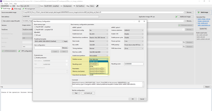

diego_charles
Hi @leoo599
I am very sorry for the delayed reply.
Could you please test with our MCUXpresso Secure Provisioning Tool ? It supports created and dowloading eMMC bootable images. The boot memory configuration area of the tool enables you to select your desired partition access.
Please let me know if this helps you, or if you have found out something else in the meantime.
Thank you for your patience.
