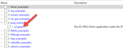

1) Do you have any example code to update text on LCD or Image loading in LCD ?
-- To provide the fastest possible support, I'd highly recommend you to refer to either emWin or LVGL demo in the SDK library.
2) I can see in SDK_2.3.0_EVK-MIMXRT1050 example given sd_jpeg but seems discontinued in SDK_2.9.1_EVKB-IMXRT1050. Could you please provide for SDK_2.9.1_EVKB-IMXRT1050 version also?
-- Please import the sd_jpeg demo as the below figure shows.

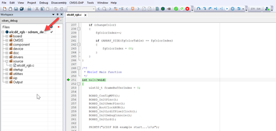

After selecting the sdram_debug option, I run the elcdif_rgb demo on the MIMXRT1050, actually, it can work well and I've not encountered the issue you mentioned.
BTW, I also use the SDK_2.9.1_EVKB-IMXRT1050

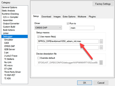

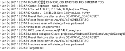

SDK is working fine. We have created our own eLcdif module by taking reference from SDK_2.9.1_EVKB-IMXRT1050 and we are not using any startup.s file. But in case our elcdif when using SDRAM MIMXRT1052xxxxx_sdram linker file, it is going to hardfault or reset. But with linker file MIMXRT1052xxxxx_ram.icf, It is hitting correctly to main(). Is there any settings requires ? or do we need to initialize SDRAM to boot from this ?
In case of SDK using SDRAM linker file
In case of our Lcdif using SDRAM linker file

1) Is there any settings requires ? or do we need to initialize SDRAM to boot from this?
-- Please check the below debug setting.
From my experience, you'd better port your demo project to the elcdif_gdb demo project for testing.
Have a great day.

shaileshnsec
Now I am able to boot correctly.
Not related to boot, I am working on LCD,  We are able to perform RGB. Do you have any example code to update text on LCD or Image loading in LCD ?
I can see in SDK_2.3.0_EVK-MIMXRT1050 example given sd_jpeg but seems discontinued in SDK_2.9.1_EVKB-IMXRT1050. Could you please provide for SDK_2.9.1_EVKB-IMXRT1050 version also ?
Thanks/ Shailesh

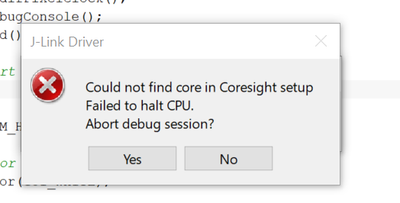

shaileshnsec
HI,
After running emwin_temperature_control,
I am getting below issue,
any way to recover this
