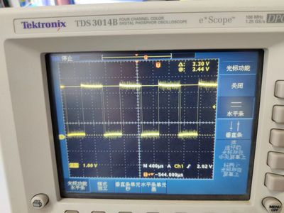

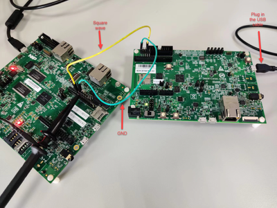

jeremyzhou
Hi @michaeldkfowler ,
Thanks for your reply.
I don't have a signal generator on hand, so I use a MIMXRT1170 board to generate the square wave to simulate it, you can see the wave below figure, further, I connect the wave to the J24-4 pin or other J24 pins, actually, it doesn't affect the boot-up process.
TIC

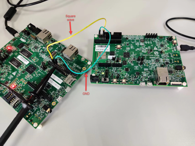

jeremyzhou
Sorry for replying late, as I was not at the office since Thursday in last week.
Whether you mean the MIMXRT1170 board as the signal generator generates the square wave output to the MIMXRT1050 board, then plugging the USB cable to the MIMXRT1050 board, as the below shows.

michaeldkfowler
yes
3,932件の閲覧回数
jeremyzhou
After several rounds of testing, the MIMXRT1050 still can boot up successfully, even though plugging in the USB cable after starting the signal generator.
