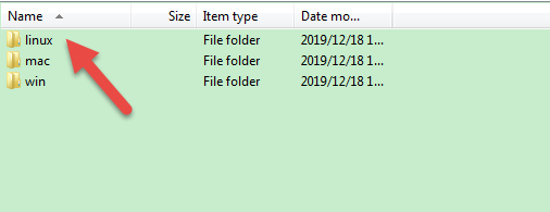

I think you'd better use the elftosb tool under the linux folder as below shows.

Thanks for your response.
I am using a Windows 10 machine (on an Intel 64 i7-8665U) - I just use the Ubuntu linux terminal, not the linux operating system (because I prefer it to the windows cmd prompt).
Also under that directory I have just amd64 and i386 folders:
$ ls -la ../../Flashloader_RT1020_1.0_GA/Tools/elftosb/linux
total 0
drwxrwxrwx 1 ronnie ronnie 512 Dec 2 11:34 .
drwxrwxrwx 1 ronnie ronnie 512 Dec 16 15:06 ..
drwxrwxrwx 1 ronnie ronnie 512 Dec 2 11:34 amd64
drwxrwxrwx 1 ronnie ronnie 512 Dec 2 11:34 i386
Which do not match my machine.

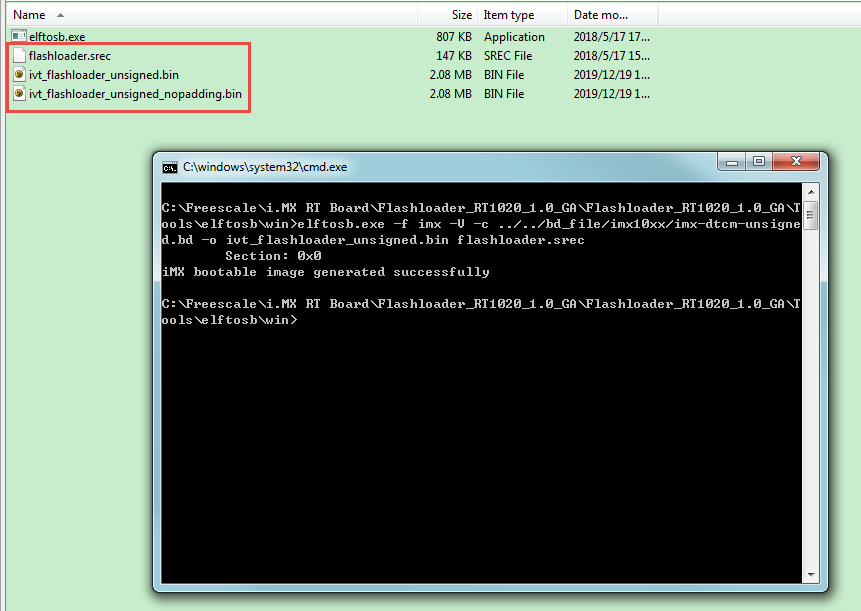

In further, I've done the same testing as you did, and it works well on my PC (Fig 1). So I'd like to suggest you can give a try again on another PC.
Fig 1

Many thanks. It looks like the only difference between my .bd file and the one you used (imx-dtcm-unsigned.bd). Is the line:
My file:
srecFile = extern(0);
Your file:
elfFile = extern(0);
So even though we are giving elftosb a file ending in .srec, we still need the elfFile variable name. I was just following the document Flashloader_RT1020_1.0_GA\doc\i.MX MCU Manufacturing User's Guide.pdf, which uses srecFile. So it must be wrong.
Anyway it works if I change the variable in my file to be elfFile not srecFile.
Thank you.
