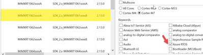

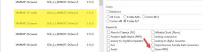

 When I configure my project for either a RT1061xxxxB instead of an RT1062xxxxA, I loose a number of options in the SDK manager including AzureRTOS. Is AzureRTOS supported on the B rev silicon and on the "1" variants in addition to the "2" variants? Thanks.

DanielRuvalcaba
Looking at the MCUXpresso SDK, it seems that Azure RTOS is not available for the device you mention.
Please see the images below.
I would recommend you to see the devices that are supported in the Download and Install SDKs option directly in the MCUXpresso IDE.
