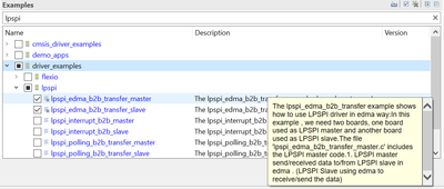

Is there an application note or any write-ups on how to use the DMA in the MXRT1062 proccessor? I would like to set it up with the LPSPI1.

Hello @lazaro,
Unfortunately, there is not an application note for the RT1062's DMA. Nonetheless, could you please take a look to the following information?
[SDK_2.x_MIMXRT1062xxxxA's examples]
Hope these helps you.
Best regards, Raul.
