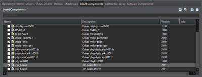

I noticed that I have two xip_board options:
This looks really weird, because they both show the same version number.
Anyway, I deselected the first xip_board and selected the second xip_board. This solved the error shown above. I clicked OK and accepted the changes to be made.

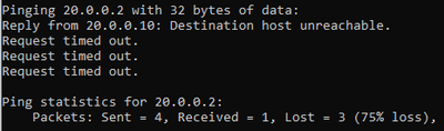

Before making these changes, I could use LWIP to connect to my computer. After updating xip_board like this, the address resolution protocol doesn't work. My PC keeps sending "Who has 20.0.0.1?", and the microcontroller doesn't respond (see attached Wireshark capture).
Before changing xip_board, I could get a response from the board by pinging it in cmd:
After updating xip_board, I don't get a response anymore:

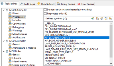

Please check whether you have enabled XIP_EXTERNAL_FLASH and XIP_BOOT_HEADER_ENABLE?

The symbols that you mentioned are indeed enabled in my original project:
