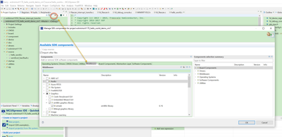

Hi @ravikant ,
   Do you mean you wand to add the middleware component in the RT1170 SDK project?
  Which IDE you are using?
  You can use the MCUXpressso IDE to add it freely.
If you don't use the MCUXpresso IDE, you can go to SDK path:
SDK_2_10_0_MIMXRT1170-EVK\middleware
and add the related source code to your own project.
Wish it helps you!
If you still have questions about it, please kindly let me know.
