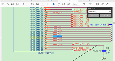

I have tried to use the MX RT1050 - EVKB board to reconstruct the experiment presented in https://www.nxp.com/docs/en/application-note/AN12078.pdf (Measuring Interrupt Latency), but I am unable to find where can I attach my oscilloscope in order to observe the GPT1_COMPARE1 signal.
Can you help me with that?
I have identified that GPT1_COMPARE1 (Port) belongs to GPIO_EMC_35 (Pad) and function GPIO3.IO[21] situated in E5 of device's ball map. The problem is that I am unable to identify this line physically on the board.

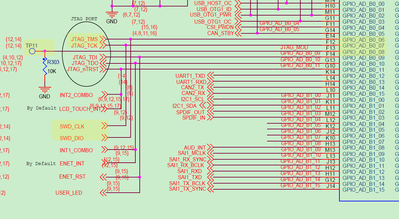

Hi @strnadel ,
   About the GPT2_COMPAREx pins can be found as follows:
In the MIMXRT1050-EVKB rev A1, the related point is:
You can find, it is the JTAG/SWD related pins.
You can use  GPT2_COMPARE3 (GPIO_AD_B0_08), it is TP11, but please note, when do the testing, make sure, when enter the debug mode, it is pull down, otherwise, the debug will be influenced.

strnadel
sending my project will not help to solve my problem - I need to know where can I attach my oscilloscope in order to observe the signal on GPT1_COMPARE1 pad of the MIMXRT1050-EVKB board. It is a pity that the authors of  AN12087 (Measuring Interrupt Latency, https://www.nxp.com/docs/en/application-note/AN12078.pdf) have not included this information in their document. I have studied more technical documentation to the board (Gerber files etc.) and it seems that the GPT1_COMPARE1 signal could be observable at the top pin of the C13 resistor situated at the bottom of the board, below the i.MX. Could you check it please? It may happen I am wrong.

kerryzhou
Hi @strnadel
  GPIO_EMC_35 as GPT_COMPARE1, on the MIMXRT1050-EVKB, this pin is really didn't fanout, so the hardware test point is really a problem, as the RT and the SDRAM are all the BGA package.
In fact, all the GPT1_COMPARE1, GPT1_COMPARE2, GPT1_COMPARE3 no directly test point for your oscilloscope .
You can consider to use the GPT2, that COMPARE pin is fan out.

kerryzhou
Hi @strnadel ,

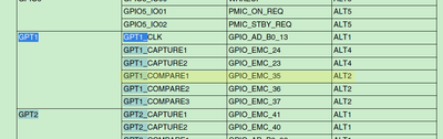

kerryzhou
Hi @strnadel ,
   From the RM, we can know the GPT1_COMPARE1 pin:
So, in the project pinmux.c, you need to configure the GPIO_EMC_35 as GPT_COMPARE1 function.
Then, you need to write the GPT code, and make the compare function works, then output to the compare1 pin.
