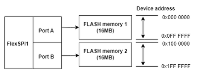

I'm using MIMXRT1176 where M7 is in XIP mode (on FLEXSPI1 port A) and M4 is running in SDRAM. I'm trying to access FlexSPI1 port B but without any luck. I've already followed some documentation, for example:
In my setup we have flash memory for MCU program on FlexSPI1 port A and then another flash memory for data on FlexSPI1 port B.
In my actual state I initialize M7 core and jumps into a function that runs in RAM memory until M4 initialization isn't done. That works fine.
On M4 I'm trying to access FLEXSPI1 port B and read vendors ID from flash memory. However, no matter what I try I always read vendors ID from the MCU flash memory. This is quite an unexpected behaviour because the MCU flash memory is on port A1 and I'm using FLEXSPI_TransferBlocking() for port B1.

I've made sure that I tell the XIP that there's another flash on FlexSPI1 (through the sflashB1Size). The internal loopback is there for a reason.

It seems like I figured out what was the problem and now I'm able to read vendors ID from both flash memories.
I accidentally came across this thread:
where even if the solution isn't very mentioned, but the "now it works my mistake was that I took the wrong device address" at least gave me a clue that there must be something about device address.
So I've tried to play with it around and found out, even when I was not able to find any mention of this behaviour in any API documentation/reference manual I was able to find about the FlexSPI peripheral for MIXMRT1176, that the FlexSPI uses FLASH memories on both port as one big continuous FLASH memory.
That means that when you call 'FLEXSPI_TransferBlocking()' with your parameter 'flexspi_transfer_t flashXfer', the '.deviceAddress' means memory address. It's better shown on the picture below.
So in my case if '.deviceAddress = <0x0000000; 0x0FFFFFF>' I read from port A, if the '.deviceAddress = <0x1000000; 0x1FFFFFF>' I read from port B.
