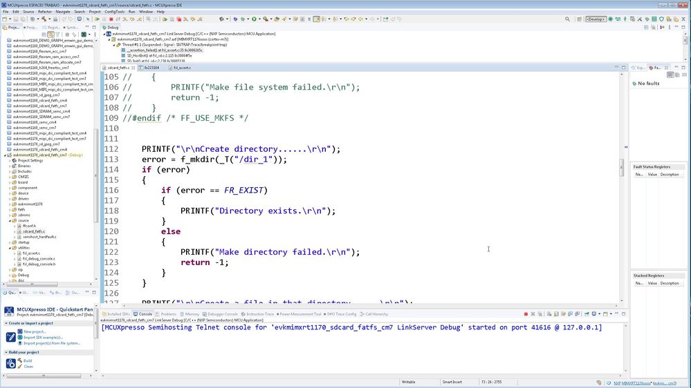

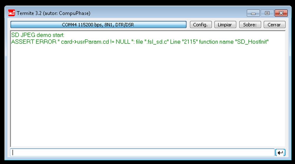

I am testing SDK examples for the evaluation boards with the RT1176 and RT1166. Everything I try with SD card access fails.
The sources are those given as examples in the SDK, I have not modified anything, and the two boards are new recently purchased. I use 8Gb micro SD cards formatted in FAT32.

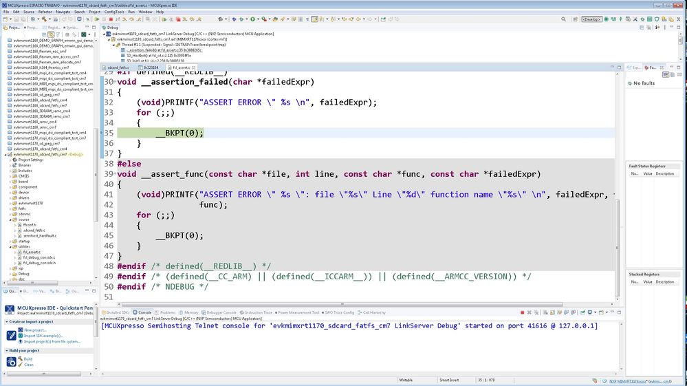

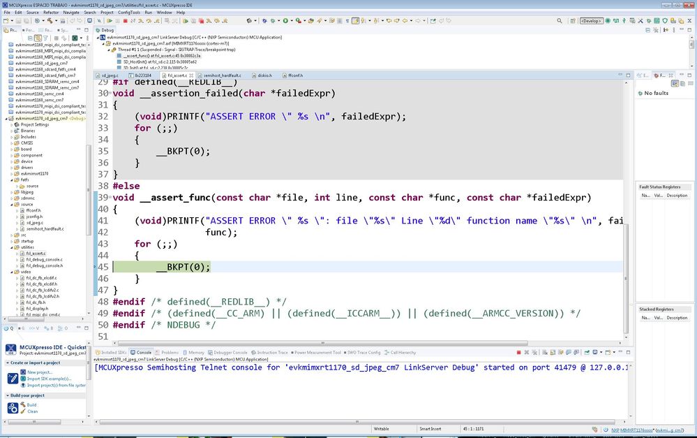

Attached screenshots of the errors, ASSERT ERROR fsl_sd.c 2115.
ScreenHunter_005.jpgScreenHunter_009.jpgSD_FAIL_RT1176_RT1166_EVK.jpgSD_FATFS_FALLO_.jpgScreenHunter_002.jpgScreenHunter_004.jpg

The problem is that in the example sources of the SDK for programs with SD card, the switch of the SD card is used as Card Detect, but in the EVK evaluation boards for the RT1166 and RT1176, the DAT3 signal is used as Card Detect, so that's why it didn't work. Looking through the sources I already found where the SD card detect system is defined and I changed it. This should be documented in the project's DOC directory file, but it is not.

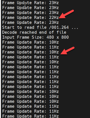

However, let's see if you can help me with another topic. I am testing the SDK sample sources to play h264 video files, I have tested it with the evaluation boards for the RT1166 and RT1176, and what I see is that the playback of the videos is very slow for a resolution of 800 * 480 and 30fps, it improves a lot with half resolution at 400 * 240 and 24fps, but this is a serious limitation to be able to use it. I was surprised that a microcontroller as powerful as the 1Ghz RT1176 is not able to decode h264 videos in run time to play them at the correct speed at a resolution higher than 400 * 240.
Can you provide me with another example source that works better to play videos with the RT1166 or RT1176 ?, I also tried the example that plays videos from looped JPEG images, but the result is the same, it is very slow.

It is the same video with different resolution and fps. The 400*240 24fps practically plays at the correct speed, the same speed as the original mp4, but with half resolution and lower fps. The 800*480 30fps video plays much slower, it is the resolution and fps of the original mp4 file.
So it seems the SDK example sources to play h264 videos with RT1166 and RT1176 and also with the sources to play JPG looped as if it were a video, there are limitations in terms of the resolution of the video, at higher resolution or fps, there comes a time when the video plays very slowly. I would say that above 400*240 24fps the playback speed starts to slow down and is no longer useful.

I basically replicate the phenomenon (as the below figure shows).
To improve the decoding performance, you can place the crucial code in the SDRAM instead of QSPI, further, you can use the FFMpeg instead of the OpenH246, as the FFmpeg has a better performance in decode and please refer to the post.
