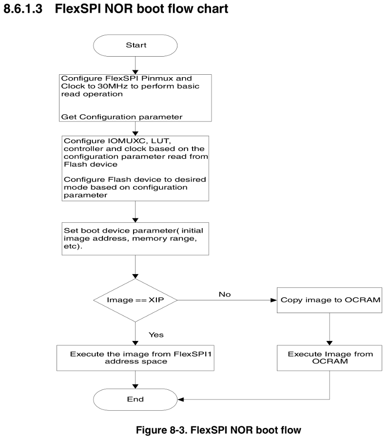

The reference manual
There are clues in the reference manual, but they are not conclusive.
For example:
Given what is written it might seem that the copy can only be made to OCRAM, but I believe that it can really happen in any destination. In fact here http://tiny.cc/22q90y there is an example to copy in SDRAM.

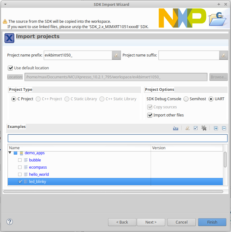

To simplify, we will start from an example provided by the SDK: led_blinky.
I imported the example keeping all the default settings:
Actually, for what we're going to do, it doesn't matter neither the library used, nor, for example, if the SDRAM is present or not (in my board there's no SDRAM), nor if the size of the flash is different.

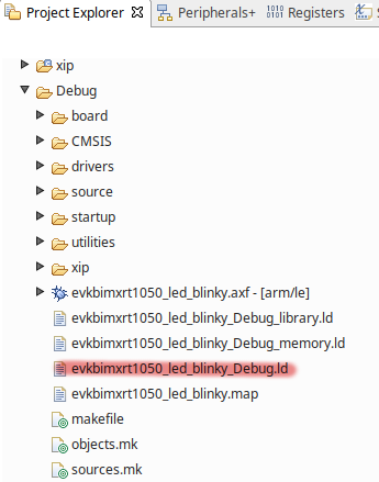

So just build (Ctrl+B)
Once the building's over, you will find the created linker script in Debug directory:

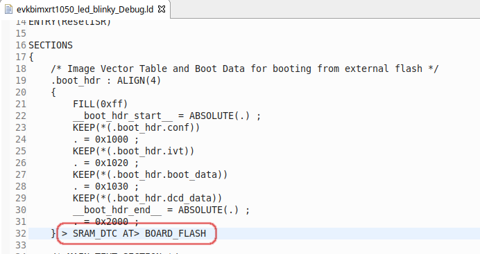

you will need to edit this script to edit the line as shown in the following figure:
This causes the boot header to be mapped to RAM.
And another line to edit is:
You have to replace LOADADDR(.text) with LOADADDR(.boot_hdr). This is used to calculate the correct size of the image.

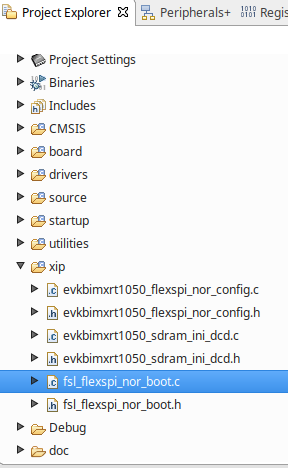

The last steps are more tricky: there is the need to edit a file provided by the SDK, which, in my opinion, is wrong.
The file is xip/fsl_flexspi_nor_boot.c
It's contents is:
And here is the IVT format:
if you try to follow the IMAGE_ENTRY_ADDRESS symbol you will see that it is defined as the address of the interrupt vectors. In my opinion this is wrong. According to the description of IVT format it should be the address of the ResetISR function.

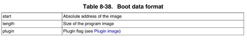

Here is the Boot Data format:
In the fsl_flexspi_nor_boot.c Boot Data is populated with the address of the flash and the size of the flash. In my opinion this is wrong. Start field sould be in DTCM and length should be the actual size of the image.
Since I wanted to copy also boot header I modified the file as follows:
