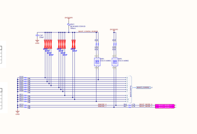

I am opening a new ticket as I have not received anymore replies on my old one. Is it possible to talk to an FE on how to make this work. W25Q64JV flash on a 1062. The programmer programs the flash just fine using the flash loader provided by NXP. Why doesn't the chip just jump to flash and take off?
The last post said compare the timings between the two chips. But Where do I change these timings even if I found a timing difference. Why does it work just fine with the programmer if their is a timing problem?

I was wondering if you can share the link to your previous post, furthermore, I was wondering if you can describe the testing environment, such as schematic, issue arising ratio, testing process, etc.

It should be known, that If I use ozone and tell it to debug out of flash, It will properly set the PC to the right place and run until an interrupt happens. It is like the boot rom will not choose flash for anything.

According to your statement, it seems like you can't debug the code in the W25Q64 on your customized board, isn't my understanding right?
I'd like to know whether the FlexSPI interface is the same between the MIMXRT1060-EVK and the customize board, furthermore, I'll appreciate it if you can upload the schematic of the customize board.
