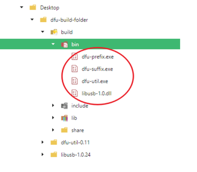

After these steps, the newly built tool will be located in the /build/bin folder.
Open cmd for Windows. Run the following command with the new dfu-suffix.exe and CRC32 will be added to the Firmware.
dfu-suffix.1 exe -a your_Firmware

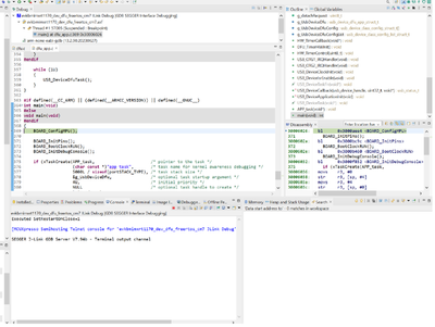

  1. Use MCUXpresso IDE to flash the dev_dfu_freertos_cm7 demo to the EVKB board.

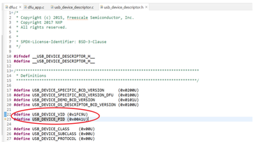

  1. In the USB Device Descriptor, we find the Vendor ID and Product ID:

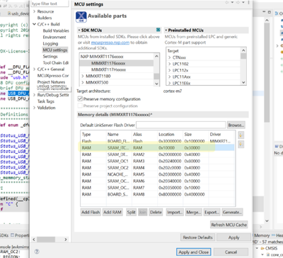

Using Custom Firmware
When using custom Firmware, ensure that the image is loaded at the correct address (e.g., 0x10000). If the offset is incorrect, the DFU demo will fail to load the Firmware, even if the CRC check passes.
To build and load custom Firmware:

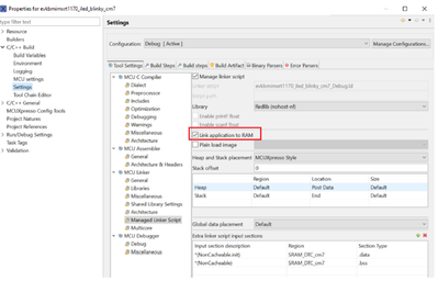

  1. Import the hello_world_cm7 project into MCUXpresso IDE.
  2. In the Managed Linker Script settings, enable "Link application to RAM".

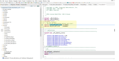

  1. Adjust memory settings to match the DFU project requirements, ensuring ITCM is the first RAM region.
  1. Build the project and generate a binary file.

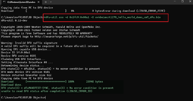

Use the modified dfu-util tool to append CRC32 to the binary and download it to the board. Verify that the custom Firmware executes correctly.
  • CRC Added:
  • New Firmware loaded successfully:
