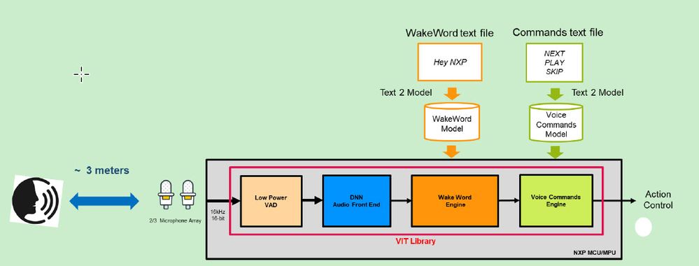

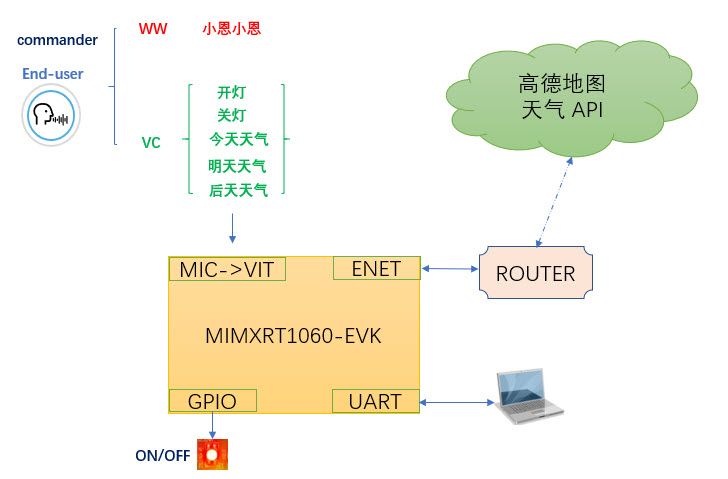

    This article will use MIMXRT1060-EVK to implement customer-defined wake-up word(WW) and voice recognition word recognition(VC) based on SDK VIT lib, and LWIP socket client to achieve real-time weather information acquisition in Shanghai, then print it to the terminal, this article mainly use the print to share the weather information, for the sound broadcasts, it also add the simple method to broadcast the fixed sound with mp3 audio data, but for the freely sound broadcast, it may need to use real-time TTS function, which is not added now.
    The system block diagram of this document is as follows:
Fig 1 System Block diagram
The VIT custom wake-up word of this system is "小恩小恩", and after waking up, one of the following recognition words can be recognized: ”开灯”("Turn on the lights"),“关灯”("Turn off the lights"),”今天天气”("Today's weather"),“明天天气”("Tomorrow's Weather"),“后天天气”("The day after tomorrow's weather"). Turn on the light or Turn off the lights , that is to control  the external LED red light on the EVK board. ”今天天气” gets today’s weather forecast, it is in the following format:

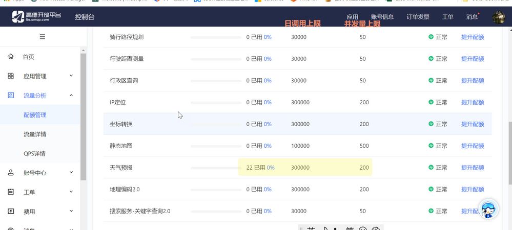

Create the account and the API key, then add the relevant parameters to implement the call of the weather API, the application for API Key is as follows:
Fig 2 Gaode map API key
The following diagram shows the call volume:
Fig 3 Gaode Map API call volume

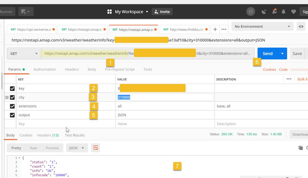

    Postman is an interface testing tool, when doing interface testing, Postman is equivalent to a client, it can simulate various HTTP requests initiated by users, send the request data to the server, obtain the corresponding response results, and verify whether the result data in the response matches the expected value. Postman download link: https://www.postman.com/
After finding the proper weather API platform and the calling link, use the postman do the http GET operation to capture the weather data, refer to the Fig 4, fill the related parameters to the postman:
Fig 5 Postman call weather API
Send Get command, we can find the weather information in the position 7, the complete all information is:

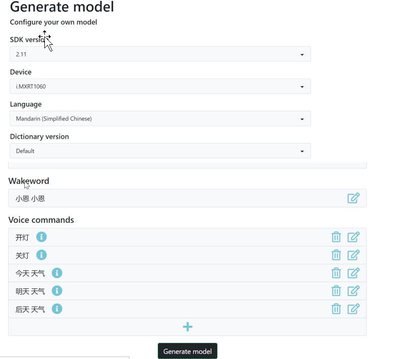

2.3 VIT custom commands
    From the maestro code of the RT1060 SDK, we can know that the SDK already supports the VIT library, what is VIT?
    VIT's full name: Voice Intelligent Technology, the library provides voice recognition services designed to wake up and recognize specific commands, control IOT, and the smart home.
Fig 7 VIT system block diagram
    In NXP RT1060 SDK code, the generated wake word and command word have been provided and placed in the VIT_Model.h file. If in the customer's project, how to customize the wake word and command word? With the NXP's efforts, we have made a web page form for customers to choose their own command, and then generate the corresponding VIT_Model.h file for code to call. VIT command word generation web page is:
https://vit.nxp.com/#/home

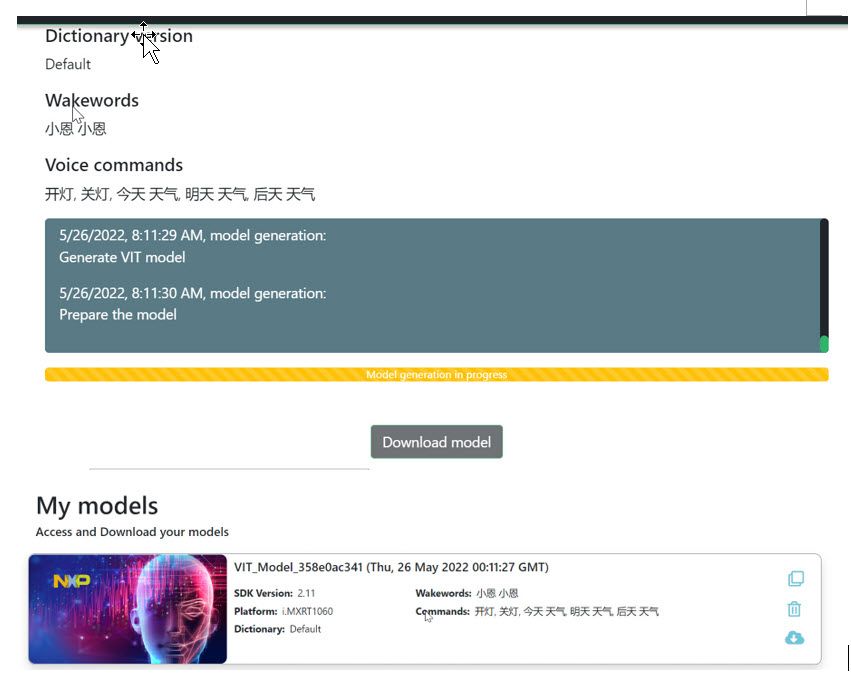

    Login the NXP account, choose the RT chip partn umber, wakeup word, voice command. Please note, the current supported RT chip is:
RT1060,RT1160,RT1170,RT600,RT500
The following is the example for generating wakeup word and voice command:
Fig 8 Custom VIT configuration
Fig 9 generated result
Download the generated model, you can get VIT_Model_cn.h, open to see the command word information and related model data stored in the const PL_MEM_ALIGN (PL_UINT8 VIT_Model_cn[], VIT_MODEL_ALIGN_BYTES) array, the command word information is as follows:
WakeWord supported : " 小恩 小恩 "
Voice Commands supported
    Cmd_Id : Cmd_Name

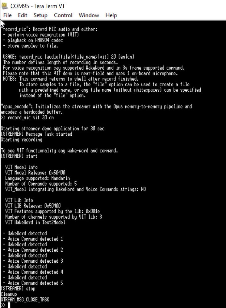

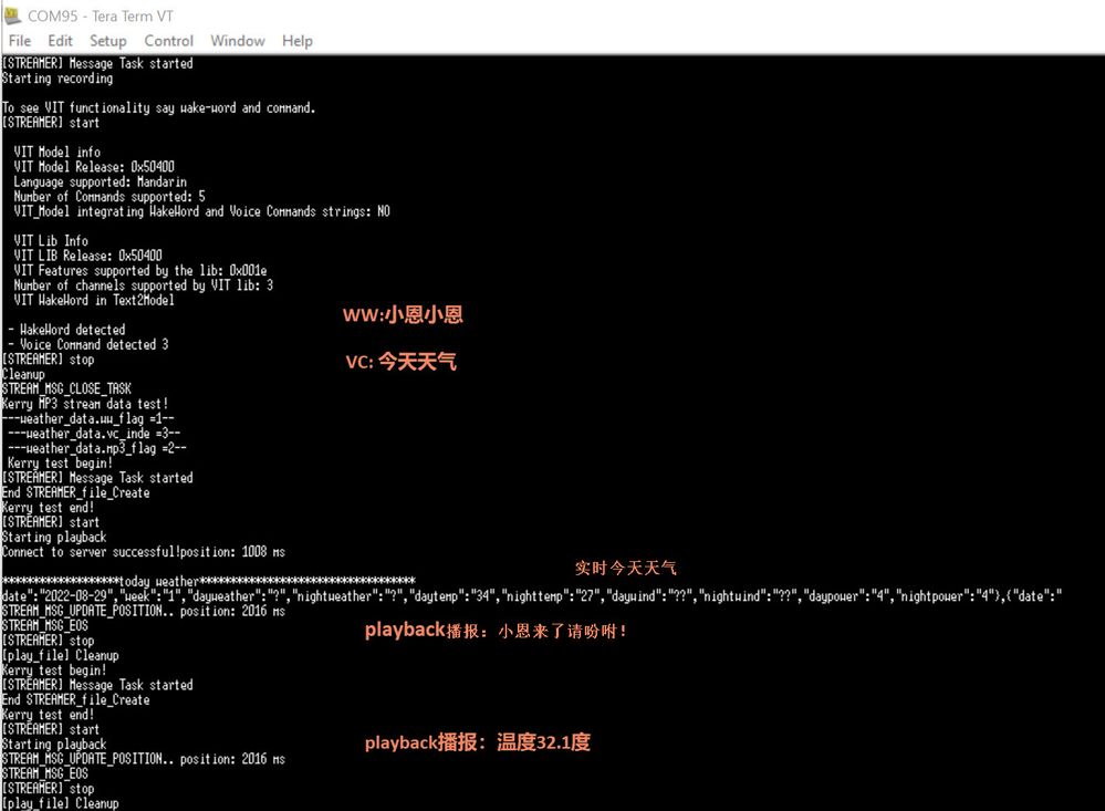

Use the RT1060 SDK maestro_record demo to test this custom command result:
Fig 10 Custom Wakeup word and voice command test
From the test result, we can see, both the wakeup word and voice command is detected.

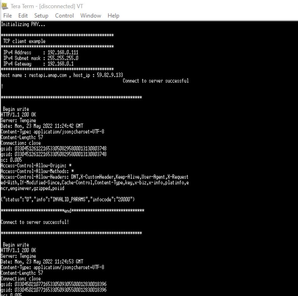

3.1 LWIP socket client code capture weather API
From chapter 2.2, we have been able to obtain the weather API and through testing, we can successfully achieve weather acquisition, so we need to add relevant commands in combination with the needs of our own system. For the acquisition of the weather API, the lwip code based on the RT1060 SDK is in the form of socket client. The relevant code is as follows:

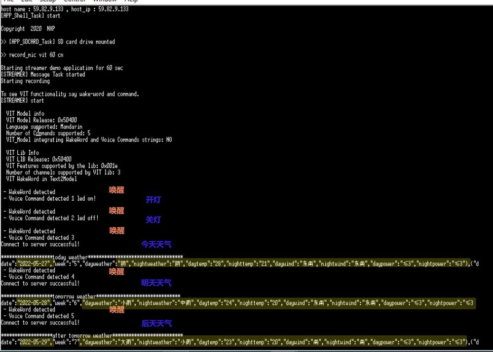

 3.3 Voice recognize weather information
   In the weather_thread while, check the wakeup word and voice command, if meet the requirement, then create the socket connection, write the API and capture the weather data.
The related code is:

4 Test result
 the test result video:
Print the log results as shown in Figure 11, after testing, you can see that the wakeup word and voice command can be successfully recognized, in the recognition of word sequence numbers 3, 4, 5 is the weather acquisition, you can successfully call the lwip socket client API, successfully obtain weather information and printf it.
Fig 11 system test print result

5.1 LWIP failed to get weather
   When creating the code, call the postman provided http code:
GET /v3/weather/weatherInfo?key=8f777fc7d867908eebbad7f96a13af10&amp; city=310000&amp; extensions=all&amp; output=JSON HTTP/1.1
Host: restapi.amap.com
   Add it to the socket API function:
uint8_t get_weather[]= "GET /v3/weather/weatherInfo?key=xxx&amp;city=310000&amp;extensions=all&amp;output=JSON HTTP/1.1\r\nHost: restapi.amap.com\r\n\r\n\r\n\r\n";
   The test result is:
Fig 12 socket weather API return issues
    We can see, server connection is OK, http also return back the data, but it report the parameter issues, after checking, we use the postman C code, and put it to the get_weather:
uint8_t get_weather[]= "GET /v3/weather/weatherInfo?key=xxx&city=310000&extensions=all&output=JSON HTTP/1.1\r\nHost: restapi.amap.com\r\n\r\n\r\n\r\n";
Then, it can capture the weather data, the same as postman test result.

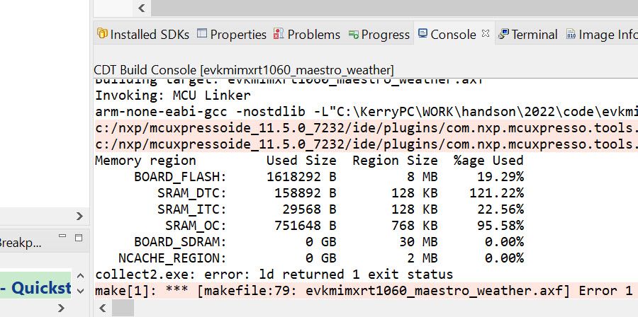

5.2 VIT LWIP merger memory is not enough
    After combining the maestro_record and lwip socket code together, compile it, it will meet the DTCM memory overflow issues.
Fig 13 memory overflow

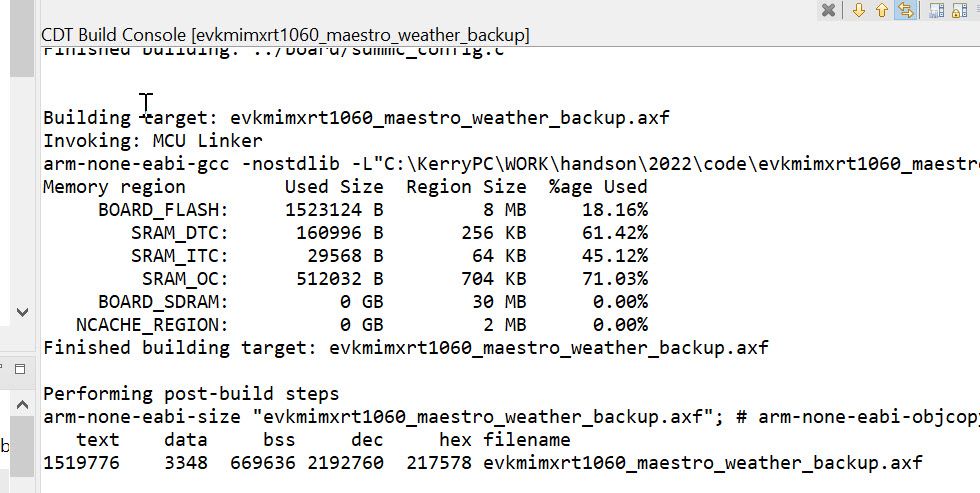

After optimize, still meet the DTCM overflow issues, so, at last, choose to reconfigure the FlexRAM:
OCRAM 192K, DTCM 256K, ITCM 64K
Compile it, and the memory overflow issues disappear:
Fig 14 FlexRAM recofiguration

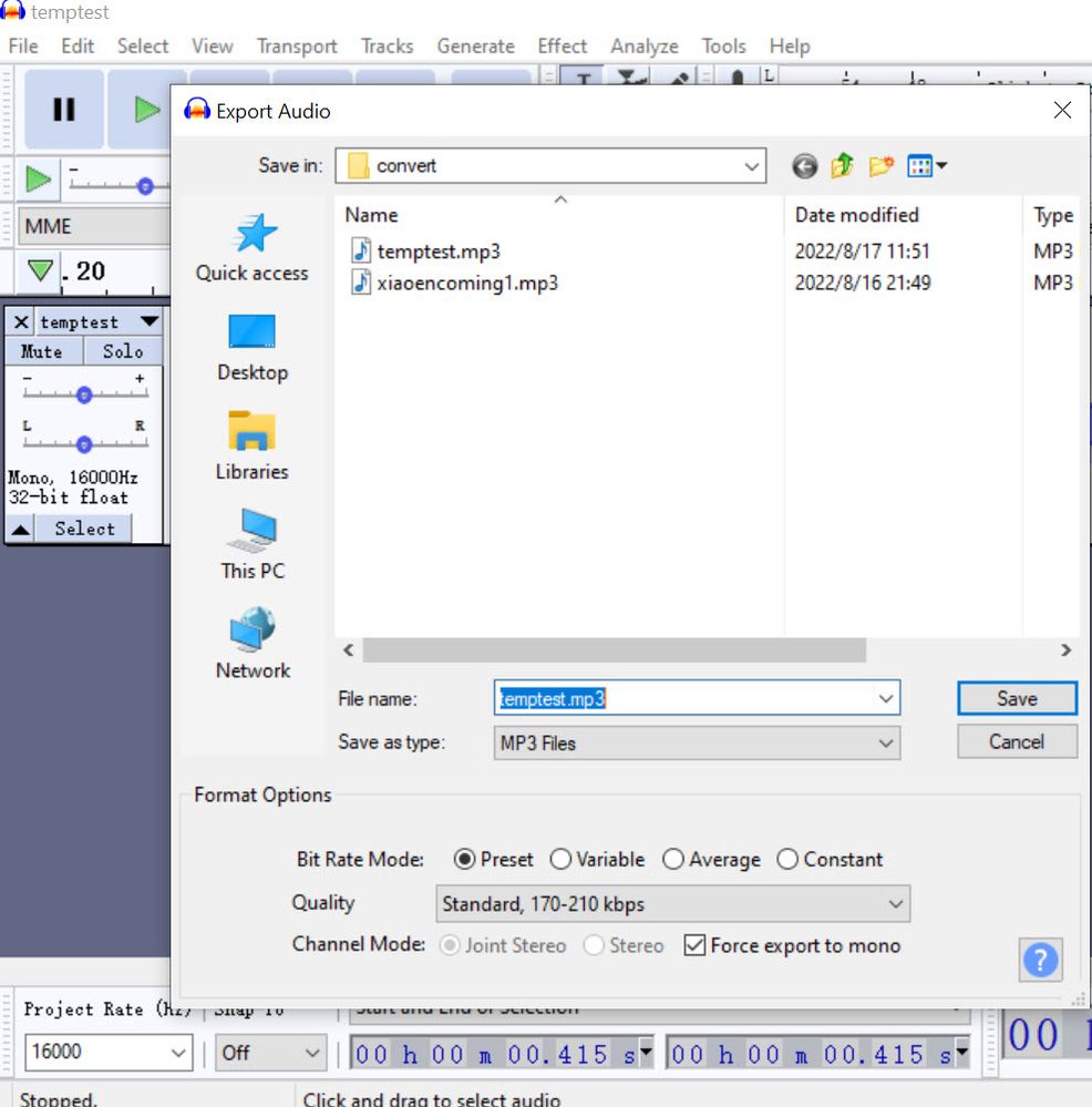

6.1 MP3 playback audio data preparation
    For audio broadcasting which need to convert the Chinese word into MP3 files, you can use some online speech synthesis software, here use Baidu online speech synthesis function, you can view the previous article, chapter 2.2.2 online speech synthesis:
https://community.nxp.com/t5/i-MX-RT-Knowledge-Base/RT106L-S-voice-control-system-based-on-the-Baidu...
    If use the Baidu online speech synthesis generated mp3 file to convert to the c array directly, it will meet the first audio play issues, so, here we use the Audacity to convert the mp3 file, the convert configuration is like this:
 Fig 16 Audacity convert configuration
    After the regeneration of mp3, you can use xxd .exe to convert the mp3 file to an array of C files, and then put it into RT-related memory or external flash , xxd .exe can be found at the following link:
https://github.com/baldram/ESP_VS1053_Library/issues/18
The convert command like this:
xxd -i your-sound.mp3 ready-to-use-header.c
Convert the xiaoencoming.mp3 and temptest.mp3 file to the C array, then modify the data to the C file, save file as: xiaoencoming.h and temptest.h.
