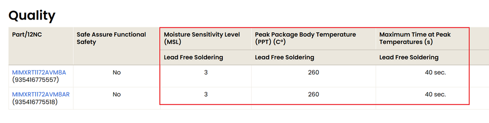

  • DataSheets (e.g, RT1170A , RT1170B) show the 'NON JEDEC' Package as following, but the Product quality page (e.g MIMXRT1172AVM8A) is marked as WSL 3 (Moisture Sensitivity Level 3), which is one of the moisture sensitivity levels defined in JEDEC-STD-020.
    • Is there a contradiction?
    • Does the product comply with JEDEC-STD-020?

3. WSL 3 and JEDEC-STD-020 Compliance
 On NXP’s product quality page, some i.MX RT1170 variants are marked as WSL 3 (Moisture Sensitivity Level 3), which is one of the levels defined in JEDEC-STD-020. This means:
  • The device can be exposed to ambient conditions for 168 hours before reflow soldering;
  • It must be stored in dry-pack packaging;
  • It complies with JEDEC-STD-020 handling and processing requirements.
This indicates that i.MX RT1170 series have been tested and qualified according to JEDEC-STD-020. Key parameters from NXP Product pages:
  • MSL (Moisture Sensitivity Level): 3
  • Peak Package Body Temperature: 260°C
  • Time at Peak: 40 seconds

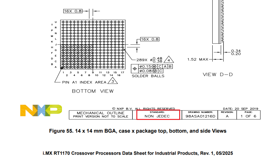

4. “NON JEDEC” Packge in the Datasheet
In the i.MX RT1170 datasheet, some package types are labeled as “NON JEDEC”, which typically means:
  • The package dimensions or layout do not strictly follow JEDEC standard outlines;
  • The device has not undergone the formal JEDEC-STD-020 certification process.
For example, the IMXRT1170BCEC Rev.1 datasheet states:
Package Information: Plastic Package 289-pin MAPBGA, 14 x 14 mm, 0.8 mm pitch
Package Type: NON JEDEC [1]
This indicates that the package is not a JEDEC-standard mechanical outline. However, it does not necessarily mean the device fails to meet the moisture sensitivity requirements defined in JEDEC-STD-020.
5. In summary
  • 'NON JEDEC' refers only to mechanical form, not to reliability standards.
  • The "NON JEDEC" marking on a datasheet refers to the ​​physical package outline​​, while the MSL 3 rating on the product quality page is a ​​reliability and handling specification​​ determined through JEDEC test methods.
  • JEDEC-STD-020 is a moisture sensitivity level testing standard for non-hermetic surface-mount devices. i.MX RT explicitly states that its MSL rating is based on the JEDEC-STD-020 testing process.
  • Whether a package conforms to a JEDEC standard (such as MO-220) has no direct bearing on whether it can be tested under JEDEC-STD-020.
