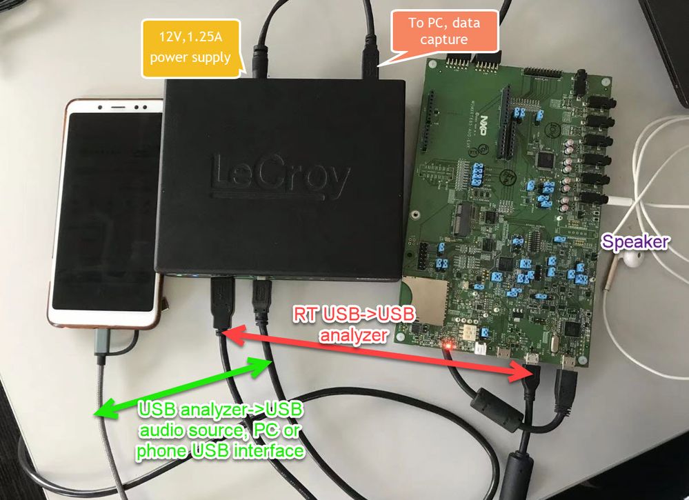

2.1 Platform connection situation
First, given the connection between MIMXRT685-AUD-EVK, USB analyzer and audio source. This article mainly tests the RT685 UAC speaker function, that is, USB transmits audio source data to RT685, and plays the audio source through a player (which can be headphones), or speaker. The J7 USB port of EVK is connected to the A port of Lecroy, and the B port of Lecroy is connected to the audio source, which can be a PC or a mobile phone. If using a PC, the speaker needs to be selected as USB AUDIO+HID DEMO, because the name of the board after UAC enumeration is USB AUDIO+HID DEMO.
The other end of Lecroy is connected to the PC for transmitting USB bus data. The specific connection diagram is as follows:
Fig 1 EVK USB analyzer connection

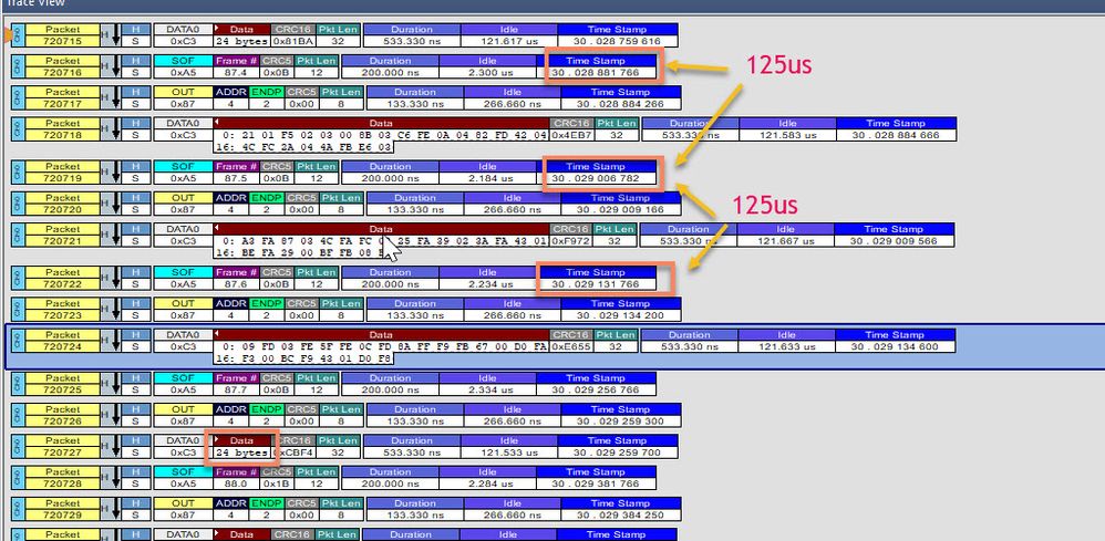

2.2.1 125us interval packet situation
#define HS_ISO_OUT_ENDP_INTERVAL (0x01)
Fig 2 125us interval
It can be seen that when the interval is configured to 125us, the SOF beat interval in front of each OUT packet is 125us, and the length of the OUT data packet is 24Byte. The data in this 24Byte packet is the actual audio data.
In this case, the playback is normal

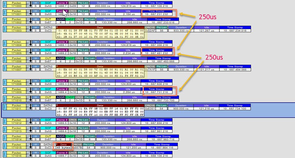

2.2.2 250us interval packet situation
  #define HS_ISO_OUT_ENDP_INTERVAL (0x02)
The packet capture configured as 250us is shown in the figure below. It can be seen that the SOF beat interval in front of the two OUT packets is 250us, and the length of the OUT data packet is 48 Byte. In other words, as the interval increases, the length of the data packet also increases proportionally, that is, the transmission time is longer, but a packet contains more data packets. At this time, the RT side also needs to provide more USB receiving buffers to receive data.
Fig 3 250us interval
This situation, the speaker play normally, have the audio sound.

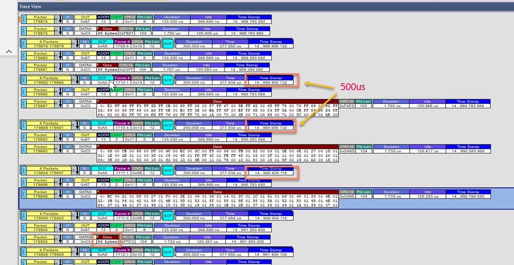

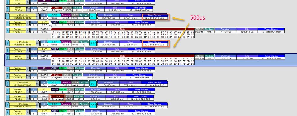

2.2.3 500us interval packet situation
#define HS_ISO_OUT_ENDP_INTERVAL (0x03)
Fig 4 500us interval SYNC mode
At this time, you can see that the data packet has become 96 Bytes, and the data content is also normal audio data, but the playback has problems and no sound can be heard.

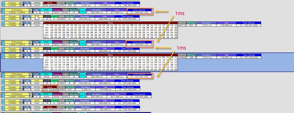

2.2.4 1ms interval packet situation
#define HS_ISO_OUT_ENDP_INTERVAL (0x04)
Fig 6 interval 1ms
It can be seen that the data packet length has become 192 bytes, and the SOF beat interval in front of the OUT packet has indeed become 1ms. The audio data packet also looks like normal audio data, so the audio data here is successfully transmitted from USB to RT. However, the playback is abnormal and no sound can be heard.

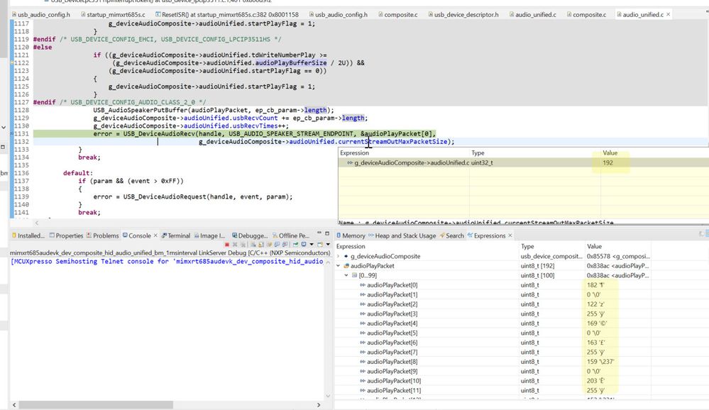

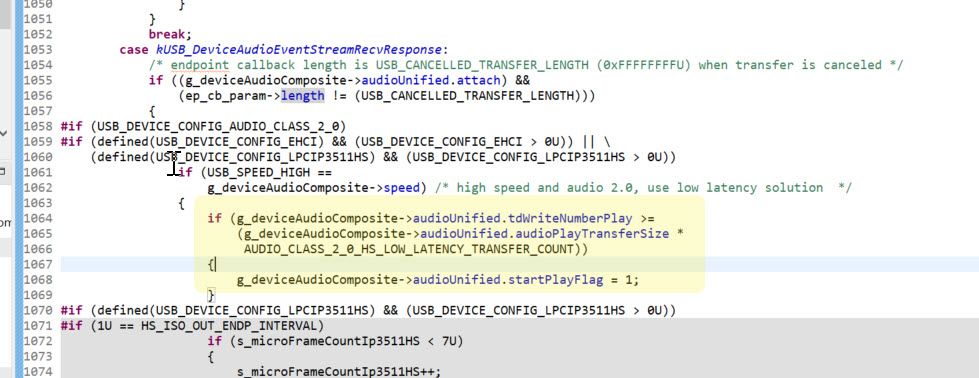

Now let's debug the project to find the problem. Because the USB analyzer can show that the audio data of the USB bus is actually transmitted, we must first check whether the USB receives the data packet in the kUSB_DeviceAudioEventStreamRecvResponse event in USB_DeviceAudioCompositeCallback of audio_unified.c, whether the data packet length is correct, and whether the data content looks like audio data. The following is the debug result:
Fig 7 data packet received situation
So from this point of view, the USB interface data packet is received, and the data looks like real audio data. If it is abnormal data, it is either all 0 or irregular data that changes, but the test result cannot be played.

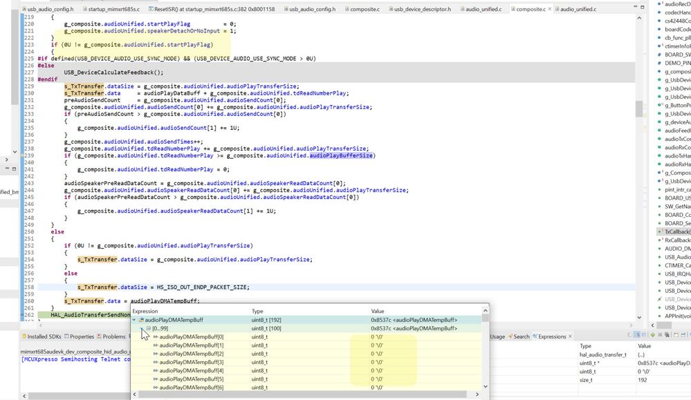

So now to check the I2S playback function, composite.h file, TxCallback function:
Fig 8 I2S play data buffer
We can see, the real data transfer to the I2S data buffer are always 0, and the reality should be
g_composite.audioUnified.startPlayFlag none zero, and also use:
s_TxTransfer.dataSize = g_composite.audioUnified.audioPlayTransferSize;
s_TxTransfer.data=audioPlayDataBuff + g_composite.audioUnified.tdReadNumberPlay;
But, after testing, audioPlayDataBuff data are also 0. So the issue should be the USB received side, receive the data, but when save the data to the audioPlayDataBuff have issues, go back to audio_unified.c

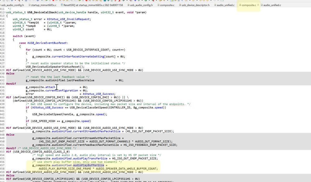

Fig 9 USB_DeviceAudioCompositeCallback

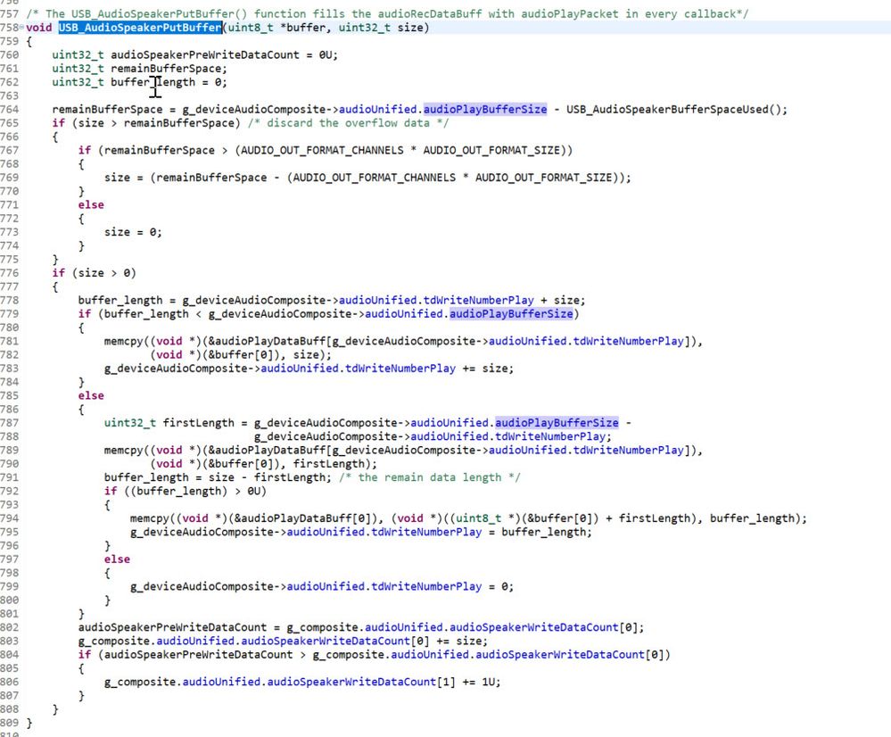

Fig10 USB_AudioSpeakerPutBuffer
After testing, in the Fig 9, audioUnified.tdWriteNumberPlay never larger than
g_deviceAudioComposite->audioUnified.audioPlayTransferSize * AUDIO_CLASS_2_0_HS_LOW_LATENCY_TRANSFER_COUNT=192*6
#define AUDIO_CLASS_2_0_HS_LOW_LATENCY_TRANSFER_COUNT \
(0x06U) /* 6 means 6 mico frames (6*125us), make sure the latency is smaller than 1ms for sync mode */
The low latency here is a delay buffer. Therefore, the USB cache data must at least be able to hold the delayed data packet. Unit 1 represents an interval frame. Now it is changed to an interval of 1ms, 6 delay units, which means that the delay here is 6ms. Here, the receiving buffer size needs to be larger, which is related to the following definition:
Fig 11 USB device callback
g_composite.audioUnified.audioPlayBufferSize =
AUDIO_PLAY_BUFFER_SIZE_ONE_FRAME * AUDIO_SPEAKER_DATA_WHOLE_BUFFER_COUNT;
#define AUDIO_PLAY_BUFFER_SIZE_ONE_FRAME AUDIO_OUT_TRANSFER_LENGTH_ONE_FRAME
#define AUDIO_OUT_FORMAT_CHANNELS (0x02U)
#define AUDIO_OUT_FORMAT_SIZE     (0x02)
#define AUDIO_OUT_SAMPLING_RATE_KHZ (48)
/* transfer length during 1 ms */
#define AUDIO_OUT_TRANSFER_LENGTH_ONE_FRAME \
    (AUDIO_OUT_SAMPLING_RATE_KHZ * AUDIO_OUT_FORMAT_CHANNELS * AUDIO_OUT_FORMAT_SIZE)
#define AUDIO_SPEAKER_DATA_WHOLE_BUFFER_COUNT \
    (2U) /* 2 units size buffer (1 unit means the size to play during 1ms) */
Here, try to set larger AUDIO_SPEAKER_DATA_WHOLE_BUFFER_COUNT, let it should be at least can put 6ms data, as 1 unit is 1ms play data size, and it needs to have more than 6ms, so, set to 12 unit, the modified definition:
#define AUDIO_SPEAKER_DATA_WHOLE_BUFFER_COUNT 12

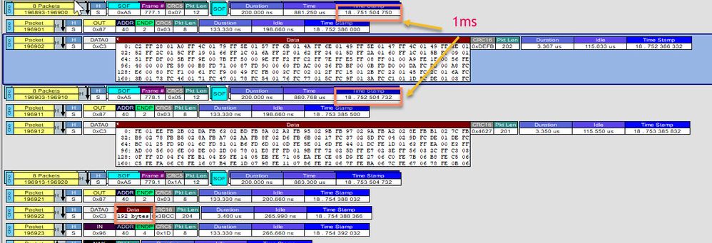

Build the project and download it, now capture the USB bus data again:
Fig 12 1ms interval data packet play successfully
This data waveform is the data that can be played normally.
