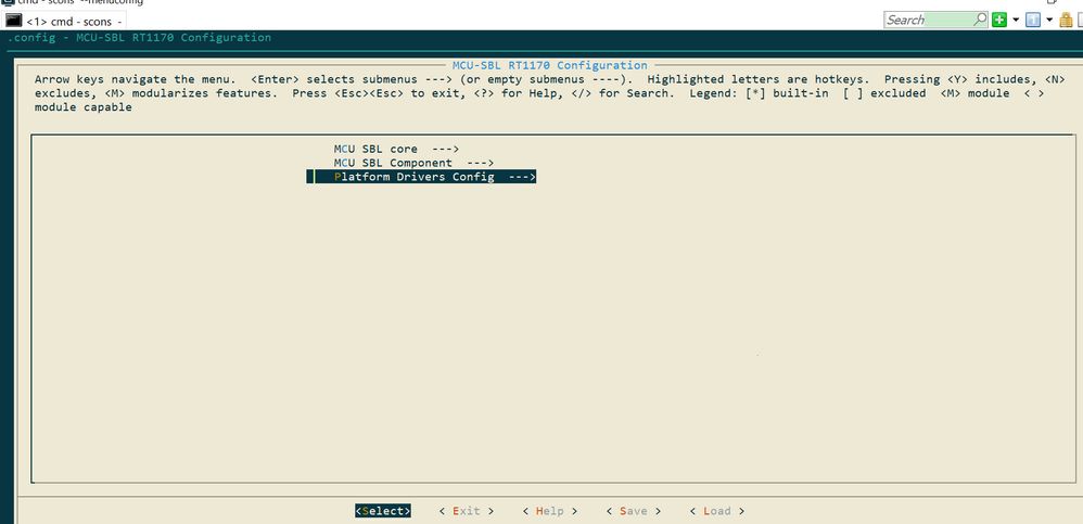

This is the SBL configuration steps:

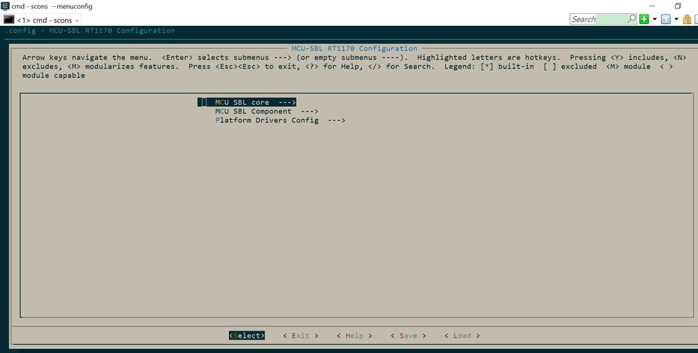

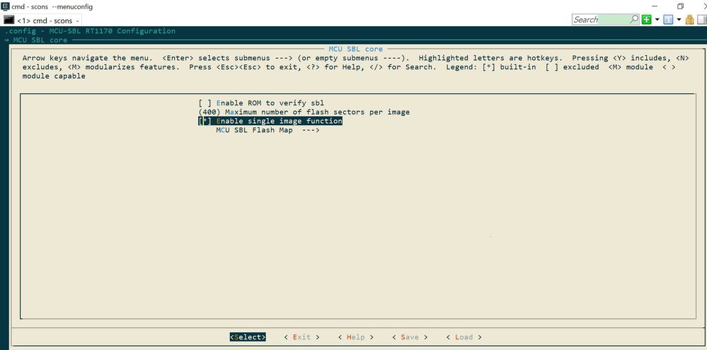

(1). Open \sbl-master\target\evkmimxrt1170\ env.bat
input:
scons –menuconfig
Fig 1
(2). Configure Single image OTA
   MCU SBL core->[*]Enable single image function
Fig 2

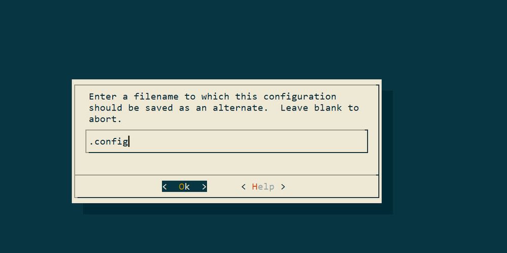

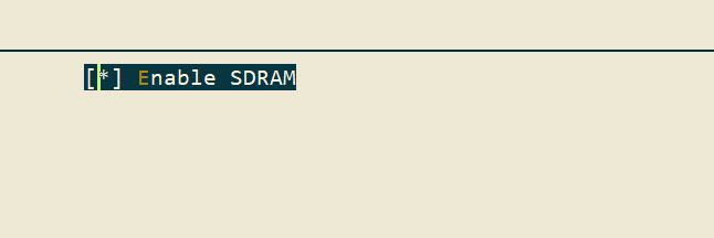

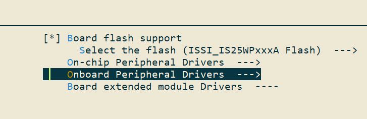

(3) Configure enable SDRAM
Fig 3
Fig 4
Fig 5
After configuration, save the .config file, save and exit it.

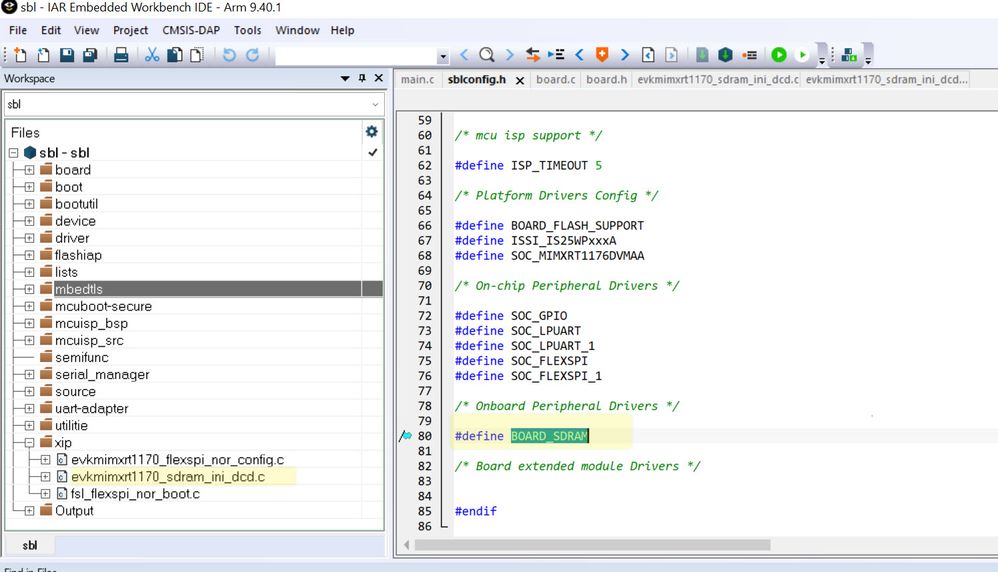

In the window, input:
scons --ide=iar
Then use IAR IDE to open \sbl-master\target\evkmimxrt1170\iar\sbl.eww
You can see, the SDRAM DCD has been added now:
Fig 7

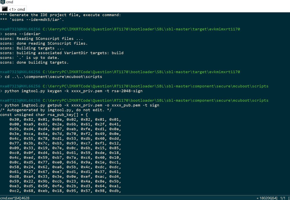

(5) Configure the secure information
Input the following command in the commander window:
cd ..\..\component\secure\mcuboot\scripts
Switch the commander path, then use the following command to generate the pub key and private key:
python imgtool.py keygen -k xxxx_priv.pem -t rsa-2048-sign
python imgtool.py getpub -k xxxx_priv.pem -o xxxx_pub.pem -t sign
Fig 8
Open the file in path:sbl-master\component\secure\mcuboot\scripts\ xxxx_pub.c, copy the pub key information, and replay it to the file in path:
\sbl-master\component\secure\mcuboot\sign-rsa2048-pub.c

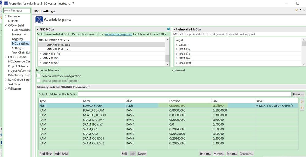

2.2 APP configuration
This document app is using the MCUXpresso IDE to import the SDK project: evkmimxrt1170_vector_freertos_cm7
Configure the flash start location to offset address:0X30100400
Fig 9

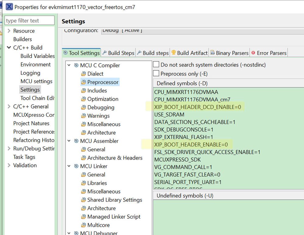

Delete the FCB and DCD header like this:
Fig 10

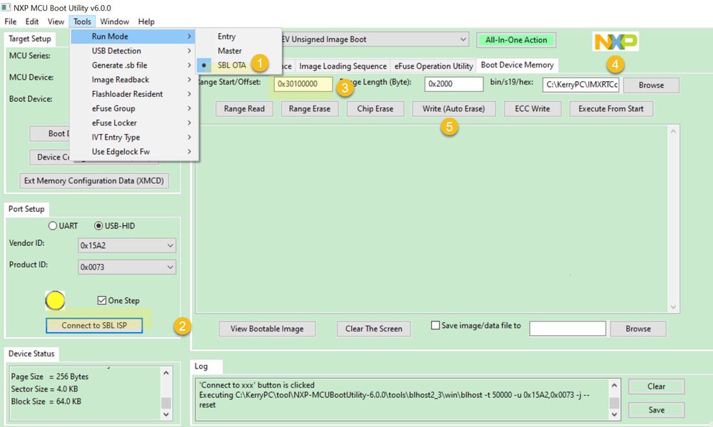

3. Test Result
After the above configuration, it already downloads the SBL to the MIMXRT1170-EVK, and prepares the used app which contains the SDRAM, now use the MCUBootutility tool to download the app2.bin.
Fig 11
Note, the Tools->Run Mode, should be SBL OTA mode.
Find another USB cable to connect the EVK SDP J20 to the PC, after the EVK board reset, within the 5 seconds, connect the board by connection the MCUBootutility button “connect to SBL ISP”, then in the Fig 11, step 4, add the prepared app2.bin, step 3, input the address to: 0X30100000, then use step 5 to download the app.

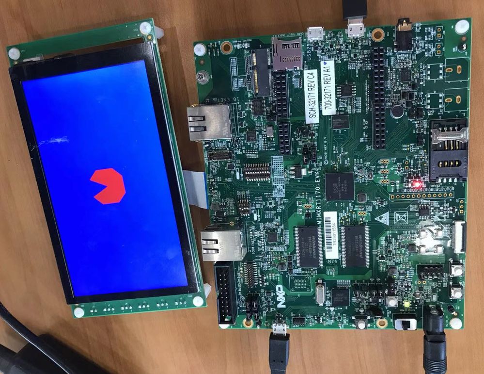

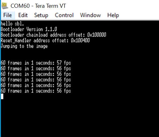

After app is downloaded, reset and exit the connection. Reset the board, wait 5 seconds, you will find the LCD can display the figure, it means the GUI code is working, and the printf log is:
Fig 12
The board displays the result like this:
Fig 13
At this point, the app with SDRAM has been successfully run in combination with SBL, indicating that the configuration of SBL with SDRAM is successful.
