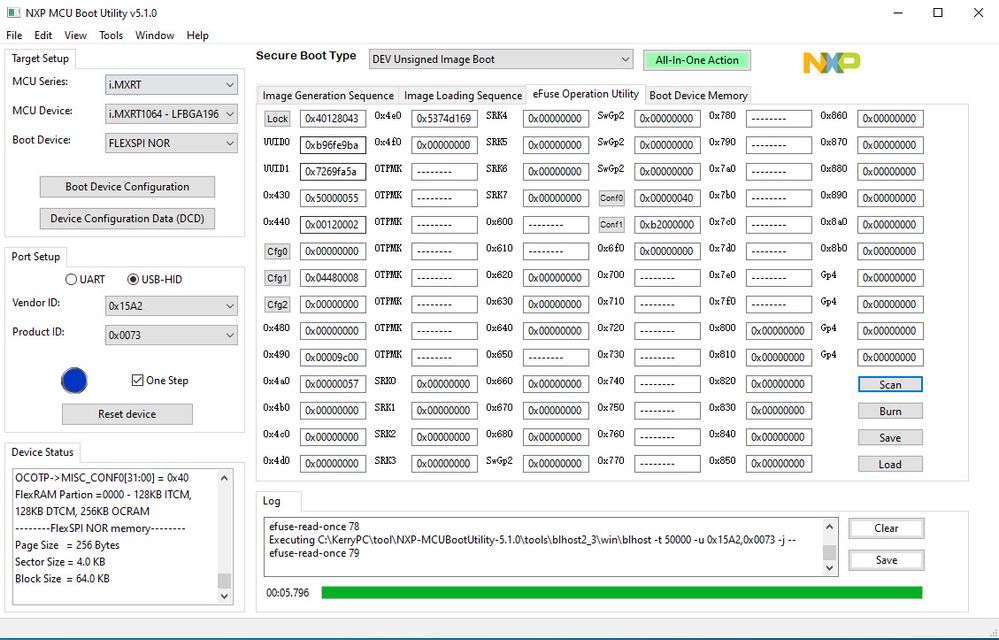

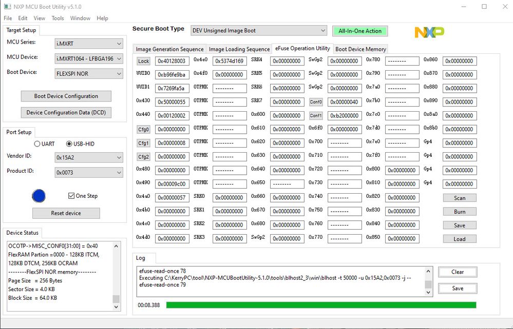

2.2 Original fuse map read
First, the MIMXRT1064-EVK board enters the serial download mode, SW7: 1-OFF, 2-OFF, 3-OFF, 4-ON. Use MCUBootUtility tool to connect EVK, and read the initial fuse map, the situation is as follows:
Fig 1

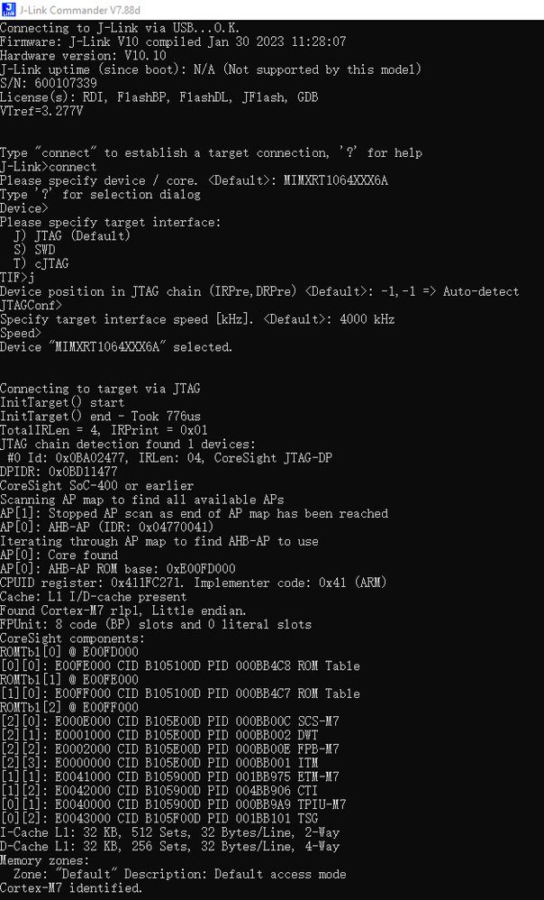

    Use the JLINK commander, JTAG method to connect the board, to find the ARM CM7 core:
Fig 3
    If the ARM CM7 core can’t be identified, it means the hardware still have issues, or the fuse modified bit is not correct, just do the double check, make sure the ARM core can be found, then go to the next steps.

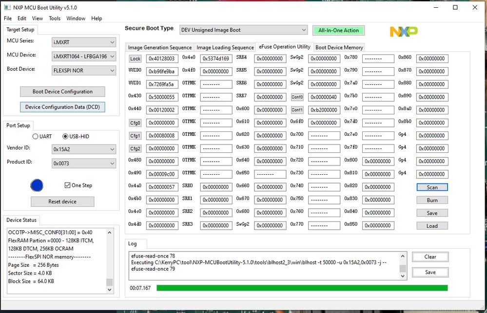

2.4 Secure JTAG Modification
    Modify fuse bit to realize Secure JTAG:
    0X460[23:22]:JTAG_SMODE =1
    0X460[26]: KTE_FUSE=1
    0X610,0X600 burn key: 0xedcba987654321, user also can burn with other custom keys, but need to record it, as the JLINKScript needs to use it.
Fig 4
In the above picture, the secure JTAG fuse and key fuse is finished, at last, to burn fuse 0X400[6]: SJC_RESP_LOCK=1, which is used to close the write and read to secret response key:
Fig 5
Here, we can see, the 0X600,0X610 key area is shadow.
Now, record the UUID0, UUID1, it will use the script to read out to check the UUID correction or not.

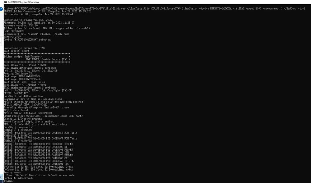

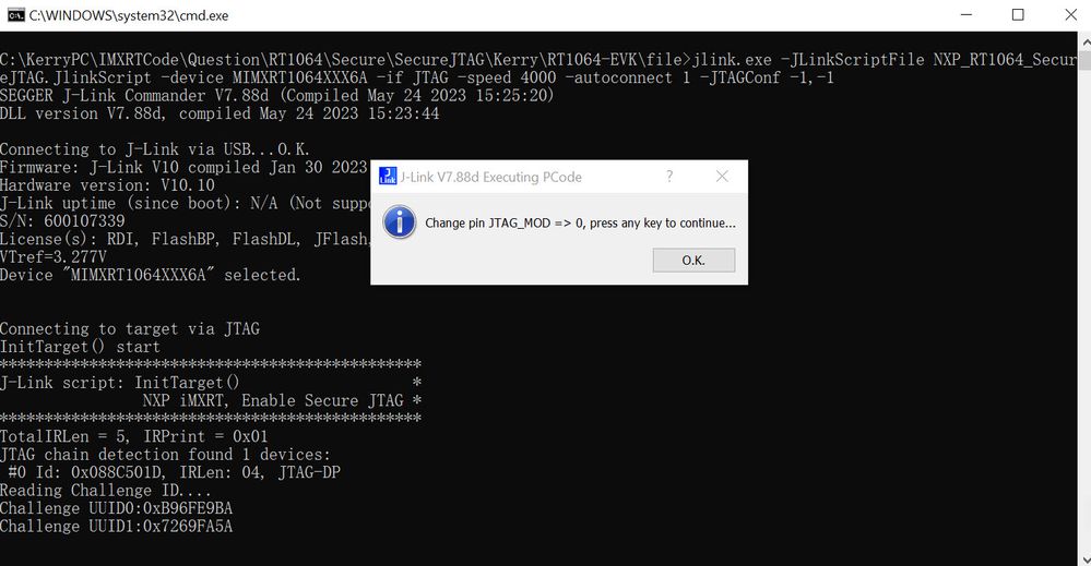

2.5 Secure JTAG JLINK commander test
Because during the secure JTAG connection process, the JTAG_MOD pin needs to be pulled low and high, so a wire needs to be connected to pull JTAG_MOD low and high. MIMXRT1064-EVK can use J25_4, which is 3.3V, and JTAG_MOD signal point can use TP11 test point. By default, JTAG_MOD is pulled low. When it needs to be pulled high, it can be connected to J25_4.
    During the test, it will need to use the JLINKScript, the content is as follows, also can check
the attached NXP_RT1064_SecureJTAG.JlinkScript file:
int InitTarget(void) {
  int r;
  int v;
  int Key0;
  int Key1;
  JLINK_SYS_Report("***********************************************");
  JLINK_SYS_Report("J-Link script: InitTarget()                   *");
  JLINK_SYS_Report("NXP iMXRT, Enable Secure JTAG *");
  JLINK_SYS_MessageBox("Set pin JTAG_MOD => 1 and press any key to continue...");
  // Secure response stored @ 0x600, 0x610 in eFUSE region (OTP memory)
  Key0 = 0x87654321;
  Key1 = 0xedcba9;
  JLINK_CORESIGHT_Configure("IRPre=0;DRPre=0;IRPost=0;DRPost=0;IRLenDevice=5");
  CPU = CORTEX_M7;
  JLINK_SYS_Sleep(100);
  JLINK_JTAG_WriteIR(0xC); // Output Challenge instruction
  // Readback Challenge, Shift 64 dummy bits on TDI, TODO: receive Challenge bits on TDO
  JLINK_JTAG_StartDR();
  JLINK_SYS_Report("Reading Challenge ID....");
  JLINK_JTAG_WriteDRCont(0xffffffff, 32); // 32-bit dummy write on TDI / read 32 bits on TDO
  v = JLINK_JTAG_GetU32(0);
  JLINK_SYS_Report1("Challenge UUID0:", v);
  JLINK_JTAG_WriteDREnd(0xffffffff, 32);
  JLINK_SYS_Report1("Challenge UUID1:", v);
  JLINK_JTAG_WriteIR(0xD); // Output Response instruction
  JLINK_JTAG_WriteDRCont(Key0, 32);
  JLINK_JTAG_WriteDREnd(Key1, 24);
  JLINK_SYS_MessageBox("Change pin JTAG_MOD => 0, press any key to continue...");
  return 0;
SecJtag.bat file content is:
jlink.exe -JLinkScriptFile NXP_RT1064_SecureJTAG.JlinkScript -device MIMXRT1064XXX6A -if JTAG -speed 4000 -autoconnect 1 -JTAGConf -1,-1
This command is mainly used the JLINK commander and JLINKScript to realize the Secure JTAG connection.
When test it, put the SecJtag.bat, JLink.exe, and NXP_RT1064_SecureJTAG.JlinkScript 3 files in the same folder.
For testing, can change the board mode to the internal boot mode, SW7:1-OFF,2-OFF, 3-ON, 4-OFF.

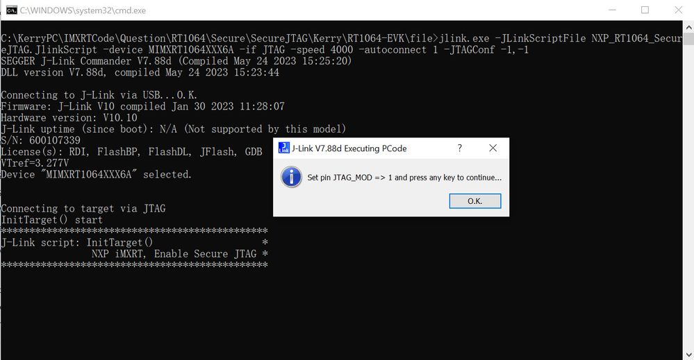

Run SecJtag.bat, the test situation is:
It indicates to connect JTAG_MOD to higher level
Fig 6
Here, use the wire to connect the J25_4 and TP11, which is connect the JTAG_MOD=1, then click OK, go to the next step:
Fig 7
It can be seen here that the correct UUID has been recognized, which is consistent with the UUID read by MCUBootutility above. Many customers cannot read the correct UUID here, indicating that there is a problem with hardware modification, or fuse modification, or another. Or in the case, the JTAG pin in the app is not enabled, which will be described in detail later.
Here disconnect the connection between TP11 and J25_4, the default is JTAG_MOD=0, click OK to continue
Fig 8
Here, we can see, the ARM CM7 core is found, it means this hardware platform already realize the Secure JTAG connection. Now, can use the IDEs to do the debugging.

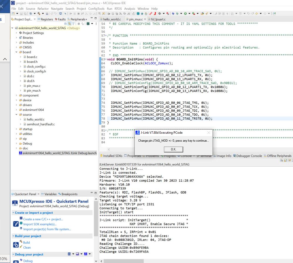

3.2 MCUXpresso Secure JTAG debug
   Use MCUXpresso IDE to import the SDK hello world demo, modify the pinmux.c, which add the JTAG pin function configuration.

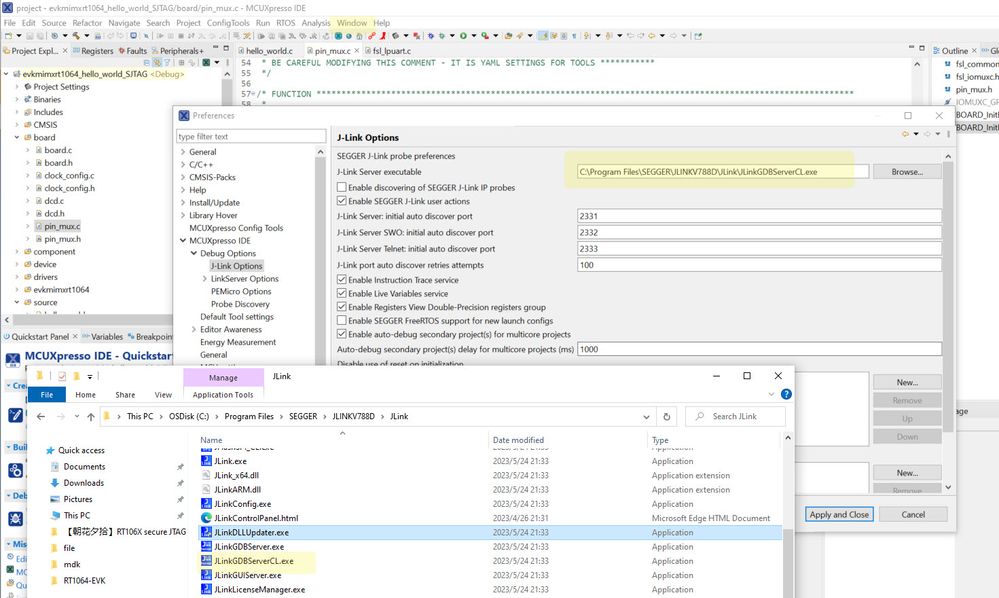

   Configure MCUXPresso ID’s debugger JLinkGDBServerCL.exe version as your used JLINK driver version, Window->preferences

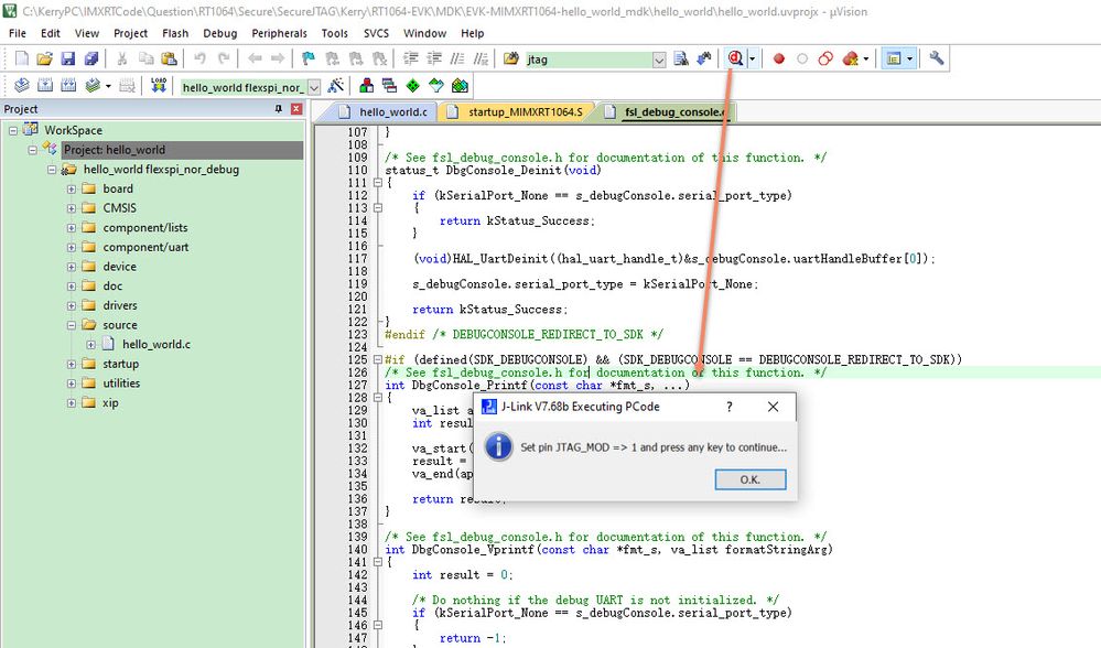

Fig 9

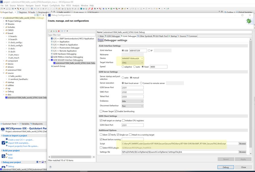

Run->Debug configurations, configure to JTAG, choose device as MIMXRT1064xxx6A, add the JLINKscriptfile
Fig10
Fig 11

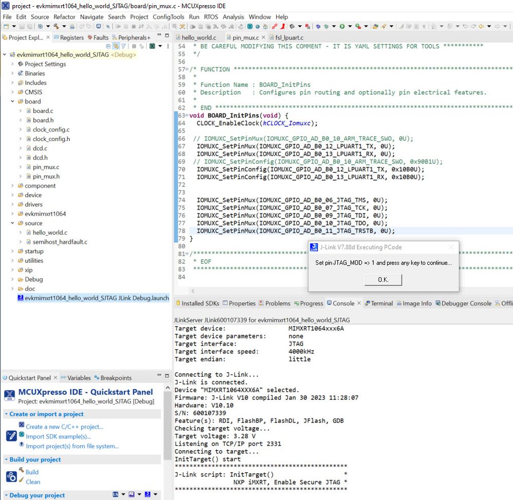

Connect JTAG_MOD=1, which is connect TP11 to J25_4, connect OK.
Fig 12
We can see, it already gets the correct UUID, it also requires connect JTAG_MOD=0, here just leave the TP11 floating, then connect OK:
Fig 13
It can be seen that at this time, it has successfully entered the debug mode and can do debugging. For details, you can check the MCUXpresso11_7_1_MIMXRT1064_SJTAG.mp4 file in the attachment.

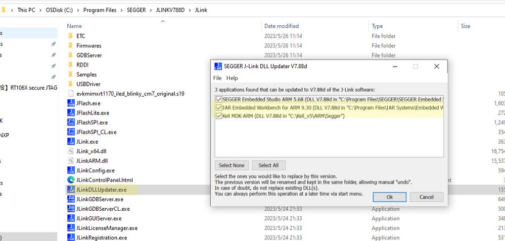

(1) Run JLINK driver:JLinkDLLUpdater.exe
Fig 14
Just to refresh the JLINK driver to the IAR,MDK IDE.

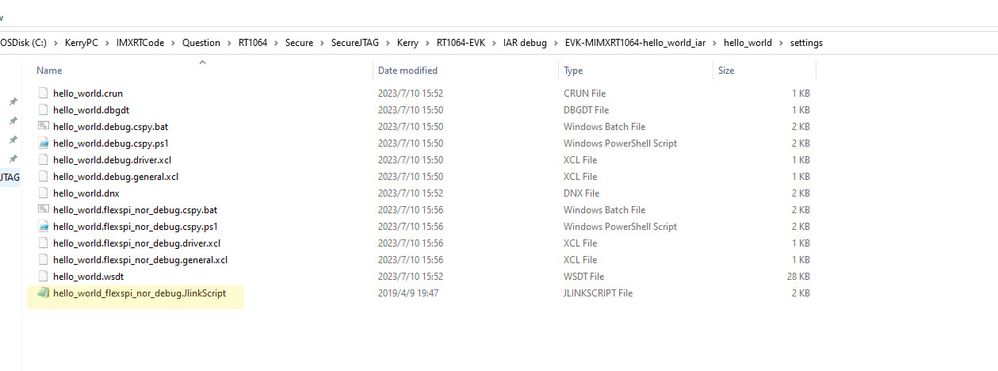

(2) Modify the file name of JLINKscript to be consistent with the name of the demo, and put it under the settings folder of the project folder. For example, the routine here is hello_world_flexspi_nor_debug, and the file name of JlinkScript is required: hello_world_flexspi_nor_debug.JlinkScript, so that IAR will automatically call the corresponding JlinkScript file
Fig15

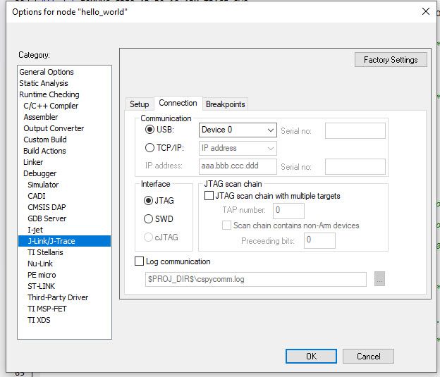

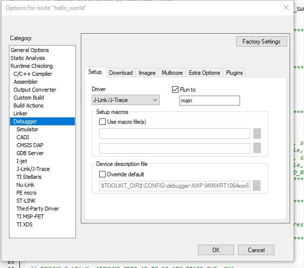

(3) Configure IAR debugger as JLINK JTAG
Fig 16
                               Fig 17

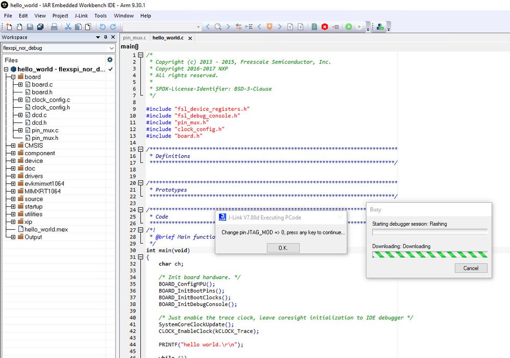

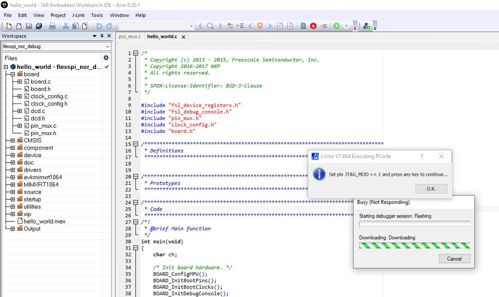

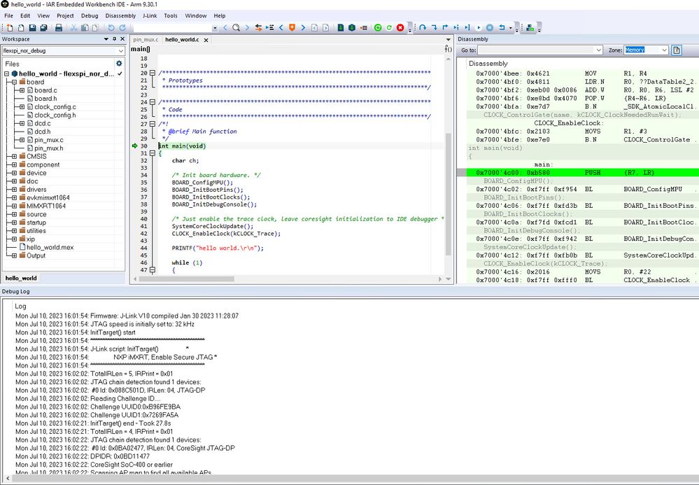

Click debug button to enter debug mode:
Fig 18
It needs to set JTAG_MOD=1, just to connect TP11 to J25_4.
Fig 19
It needs to set JTAG_MOD=0, just leave the TP11 floating, click OK to continue.
Fig 20
We can see, the IAR already can do the secure JTAG debugging.

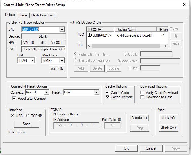

3.4 MDK Secure JTAG debug
  For the MDK secure JTAG configuration, the basic requirement is:
    (1) Modify pinmux.c code to enable the JTAG pin function
    (2) Run JLINK driver, JLinkDLLUpdater.exe,refresh the driver to MDK

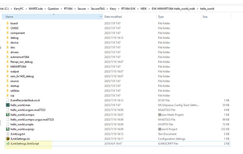

    (3) JlinkScript file name changed to JLinkSettings.JlinkScript, copy it to the folder in the mdk project, then the MDK will call the JLINKscript file automatically
Fig 21

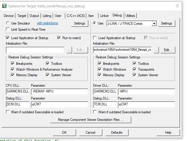

      (4) Modify debugger to JLINK, then modify the interface to JTAG
Fig 22
Fig 23

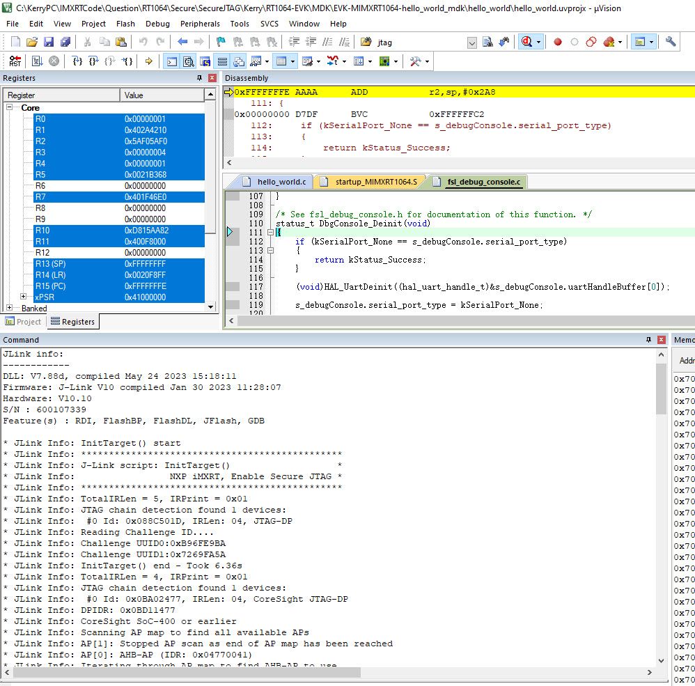

So far, the Secure JTAG related configuration of MDK has been completed. From theory, it can be directly debugged to run. But I found some problems after many tests. For the code of RAM (hello_world debug), it is no problem to be able to perform secure JTAG debug, but for the code of flash (hello_world_flexspi_nor_debug), there is no problem through secure jtag download, but the debug will run the program abnormal, check the memory data in the flash, also get the wrong data
Fig 24
We can see, UUID also correct, normally, this issue is related to the flashloader during downloading, however, the flashloader of JLINK has not been directly accessed, so I tried to use RT-UFL as the flashloader, and the debugger was successful. If customers encounter similar problems when want to use the MDK to do the secure JTAG debugging, they can use RT-UFL as the flashloader.
The reference document is:
https://www.cnblogs.com/henjay724/p/13951686.html
https://www.cnblogs.com/henjay724/p/15465655.html
To summarize it here, copy the iMXRT_UFL file to the JLINK driver folder:
C:\Program Files\SEGGER\JLINK\Devices\NXP
Copy JLinkDevices.xml to folder:
The Jlinkscript file add is the same as the Figure 21.
Modify the JlinkSettings.ini file, device is MIMXRT1064_UFL, override =1.
Fig 25

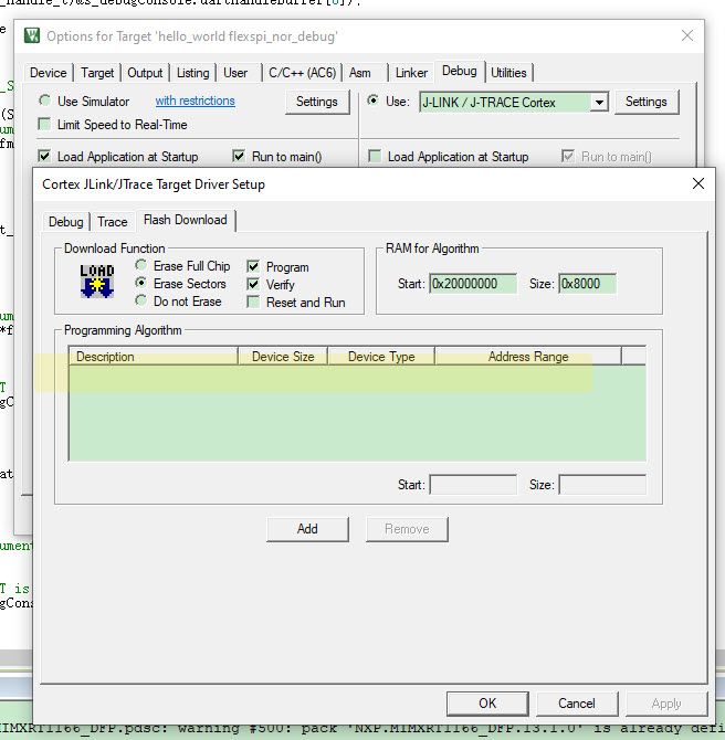

Delete the program algorithm, will use the RT-UFL algorithm
Fig 26

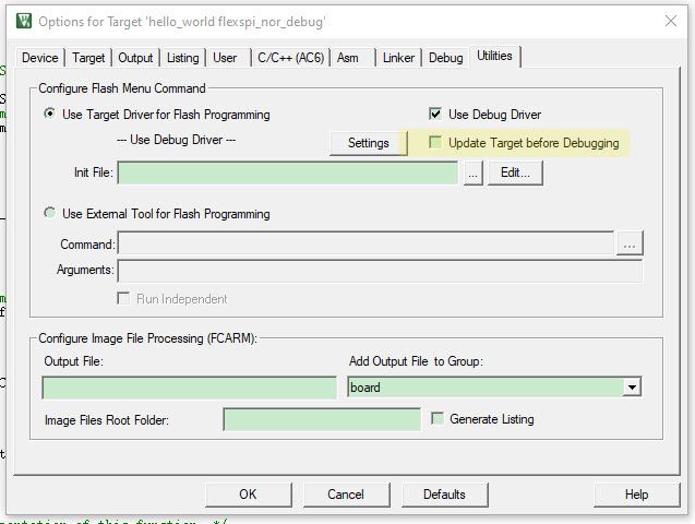

Uncheck update target before Debugging
Fig 27
Enter debug mode:
Fig 28
Configure JTAG_MOD=1, connect TP11 to J25_4, click OK to continue:
Fig 29
Leave the TP11 as floating, click OK to enter the debug mode, the result is:
Fig 30
We can see, after changing the flashloader to the RT-UFL, MDK project Secure JTAG debug also works OK, the attachment also share the RT-UFL related files.
