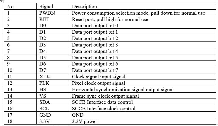

The camera module pins are as follows:
Fig 1

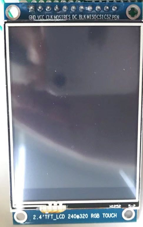

   TFT LCD picture:
Fig 2

For LCD, this article only uses the display part and does not use the rough mold part.

OV7670 signal pin and MCU MIMXRT1050-EVKB RevA1 signal pin connection situation:
0V7670 signal and pin
MIMXRT1050-EVKB revA1 signal and pin
OV7670_D0
P3
GPIO_B0_05(FLEXIO2_D05)
SW5_1
OV7670_D1
P4
GPIO_B0_06(FLEXIO2_D06)
SW5.2
OV7670_D2
P5
GPIO_B0_07(FLEXIO2_D07)
SW5_3
OV7670_D3
P6
GPIO_B0_08(FLEXIO2_D08)
SW5_4
OV7670_D4
P7
GPIO_B0_09(FLEXIO2_D09)
SW6_1
OV7670_D5
P8
GPIO_B0_10(FLEXIO2_D10)
SW7_1
OV7670_D6
P9
GPIO_B0_11(FLEXIO2_D11)
SW6_2
OV7670_D7
P10
GPIO_B0_12(FLEXIO2_D12)
SW6_3
XCLK
P11
GPIO_B0_13(FLEXIO2_D13)
SW7_2
PCLK
P12
GPIO_B0_14(FLEXIO2_D14)
SW6_4
HREF(HS)
P13
GPIO_B0_15(FLEXIO2_D15)
R258/R324
VSYNC
P14
GPIO_AD_B0_03(GPIO01_03)
J24_1
I2C_SDA
P15
GPIO_AD_B1_01(I2C1_SDA)
J23_5
I2C_SCL
P16
GPIO_AD_B1_00(I2C1_SCLK)
J23_6
PWDN
P1
GPIO_AD_B1_02(GPIO1_IO18)
J22_7
RESET
P2
GPIO_AD_B1_03(GPIO1_IO19)
J22_8
3.3V
P18
3.3V
J22_7
GND
P17
GND
J22_8

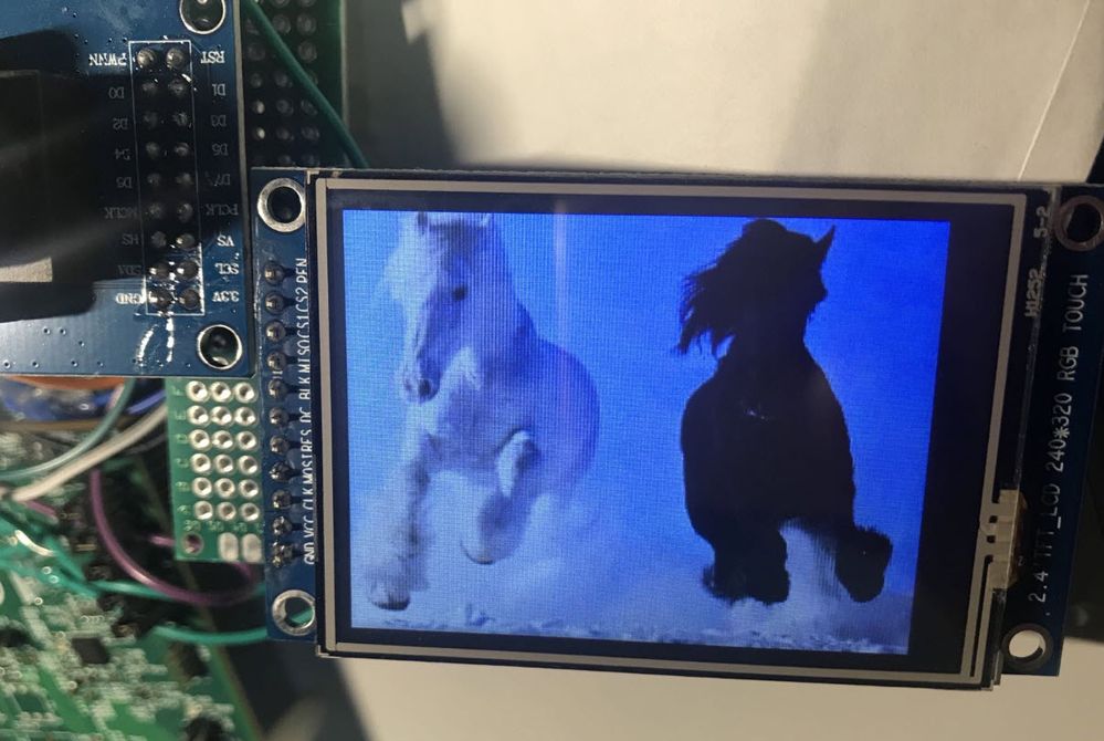

In order to reduce the impact of the signal, MIMXRT1050-EVKB removes R323, R316, R309, and D6 on the board.
The physical connection situation is as follows:
Fig 3

There is a header file of horsepic.h in the code. This file is a 320*240 RGB565 picture of a horse. It is used to test the LCD display separately. Usually after connecting the LCD, you need to test the LCD display separately. You can use a fixed picture to get the display. , here is the method of converting the picture into a C array: First adjust the picture to the LCD resolution size, and then convert it through the LVGL online conversion tool, select CF_RGB565A8, but the RGB565 generated by this format will have 1 more byte each, you can do it yourself After deletion, it can be called by code:
https://lvgl.io/tools/imageconverter
Display horse picture code:
convert8to16();
ILI9341_FillPic(0, 0, OV7670_FRAME_WIDTH-1u, OV7670_FRAME_HEIGHT-1u, (uint16_t *)(horse16));
Display result:
Fig 4
3 Test result and summarize
   About RT1050-EVKB, use flexIO to collect OV7670 data and display the situation through TFT LCD. Please check the video for the specific code situation. Check the attached source code. You can see from the video results that the flexIO OV7670 camera data can be successfully displayed and the code can successfully run the function.
