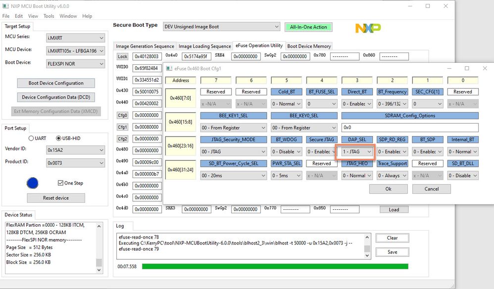

(1)Modify fuse bit 0X460[19], which is DAP_SJC_SWD_SEL, from 0-SWD to 1-JTAG.
To modify Fuse, you can enter serial download mode and use MCUbootUtility to connect and modify it.
Fig 1

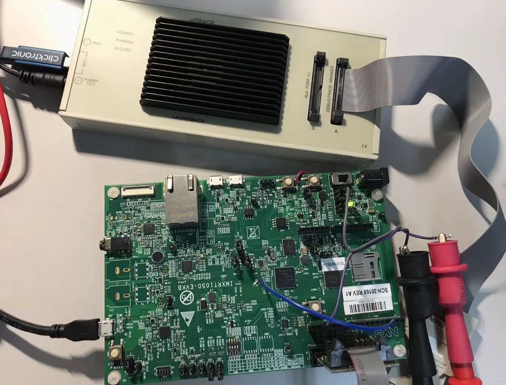

   (7) Use the external Lauterbach connect to JTAG interface J21, the connection picture is:
Fig 2

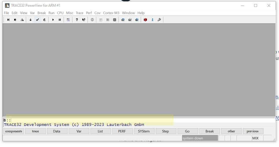

Download Lauderbach's supporting software and install it. After installation, open the TRACE32 ICD Arm USB. If the Lauderbach device is connected, the interface will open successfully.
Fig 3
At this time, you can enter the relevant commands in the yellow box in the picture above.

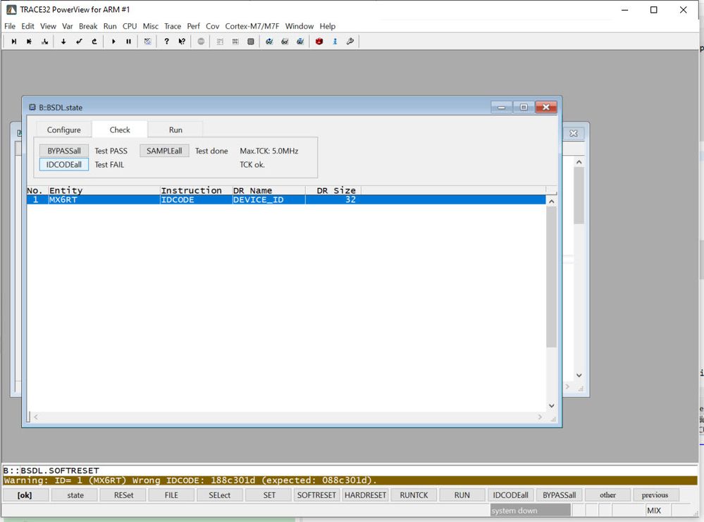

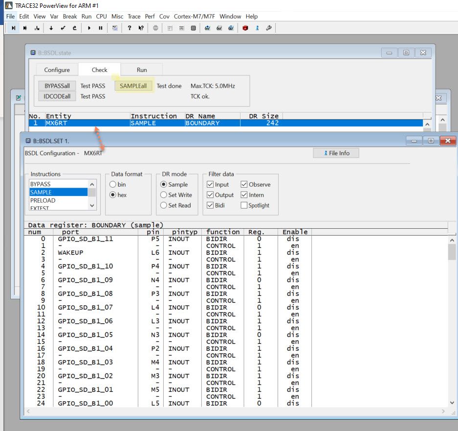

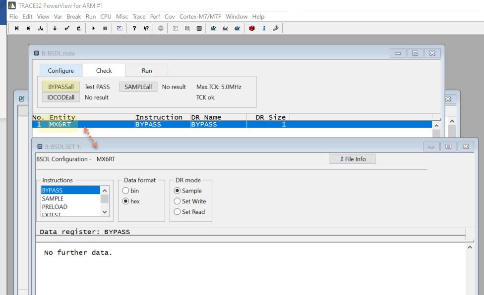

Click check->BYPASSall,IDCODEall,SAMPLEall, make sure the 3 methods can be passed.
It is found here that the following problems are encountered when clicking IDCODEall:
Fig 6

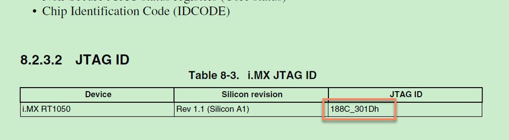

It prompts that the IDCODE read is 188c301d, but the expected IDCODE is 088c301d. So what is the correct IDCODE? You can view RT1050RM:
Fig 7

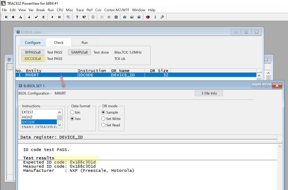

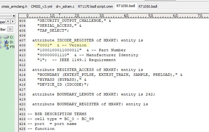

It can be seen that the currently read 188c301d is in line with RM and is correct. Therefore, the version of bsdl downloaded from the official website needs to be modified. Open the RT1050.bsdl file:
Fig 8
Modify line 408 version from 0000 to 0001,Fig 8 is the modified result. Save, run the above commands again, we can see the current BYPASSall,IDCODEall,SAMPLEall connection result is:
Fig 9
Fig 10
Fig 11

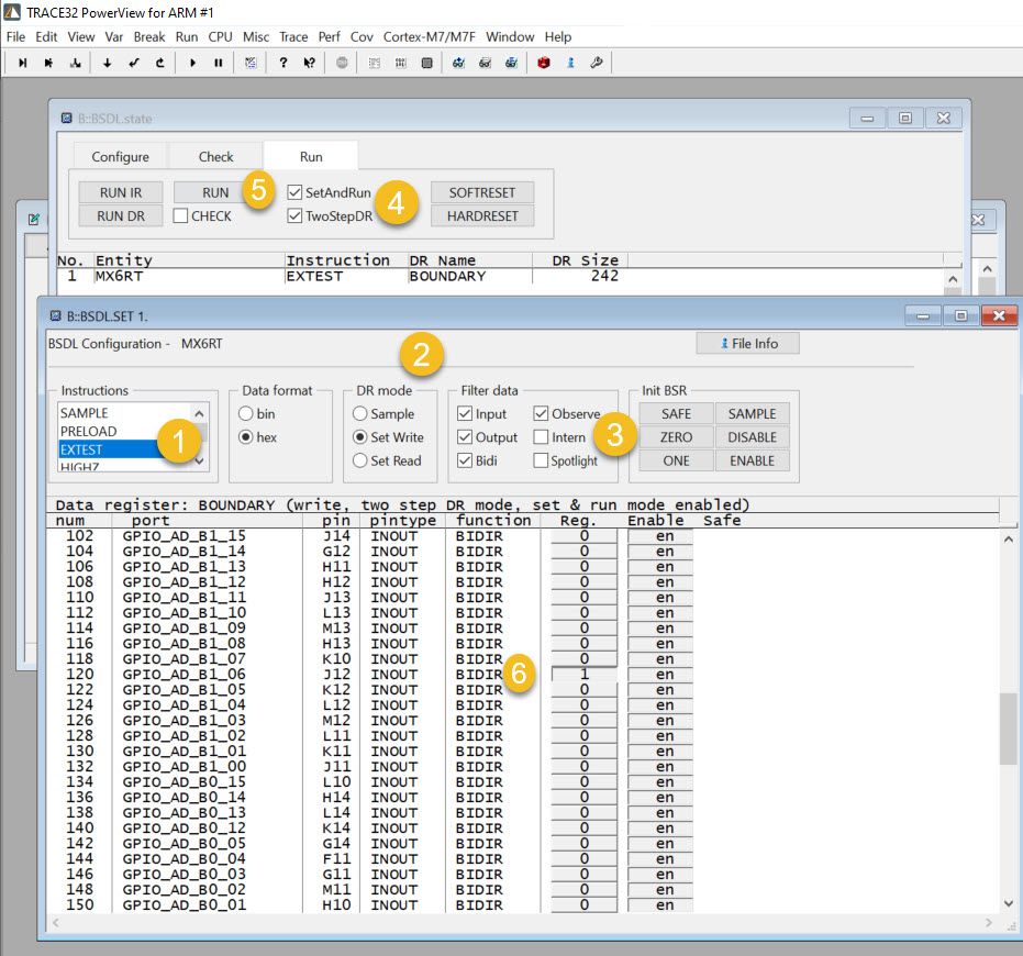

To test the output control situation you need to do:
BSDLSET 1.: instructions->EXTEXT, DR mode->Set Write, Filter data-> uncheck intern
BSDL.state->Run: check SetAndRun, TwoStepDR,  Click RUN button.
BSDLSET 1. Window, you can control the pin output status, eg, control GPIO_AD_B1_06 which is J22_2, control the output level: 1 high, 0 low.
Fig 12

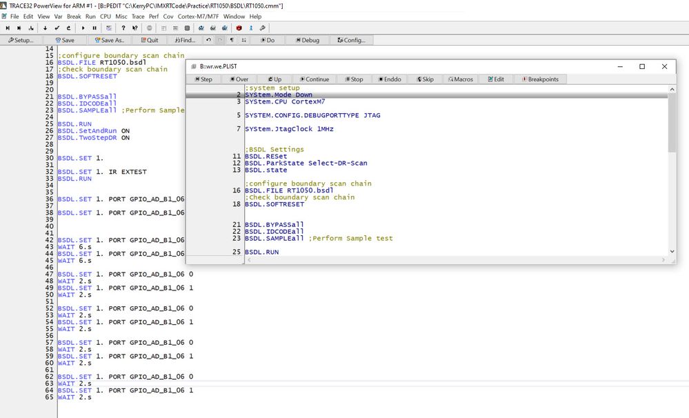

2.3 Automation control command script
As can be seen from Section 2.2, single-step operation requires manual typing of commands. In actual testing, the efficiency is very low, so scripting language can be used to directly implement automated command control.
Below, we take RT1050 as an example to control the level of the onboard GPIO_AD_B1_06 and J22_2 pins, and use a multimeter to test the high and low levels. In this way, when the TRACE32 software is opened, you only need to open the script directly, enter the debug mode, run it to the end with one click, and view the board Just turn on the light and control the status.
Script language, suffix .cmm, step: File->New Script, enter the following script command:

Function: Pull the GPIO_AD_B1_06 pin high and low 6 times, with no delay, delay 5s, delay 2s. After the script is written, save it and debug it.
Fig 13
This is the video for the testing:
It can be seen that automatic control of the onboard GPIO_AD_B1_06 and J22_2 pins can be achieved, and there is no disconnection issue when the test delay is greater than 5S, indicating that the BSDL automatic test has been completed so far. If you encounter problems, be sure to pay attention to whether the hardware modification points of the board have been completely modified.
