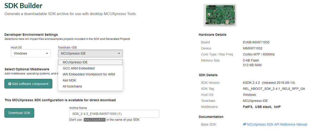

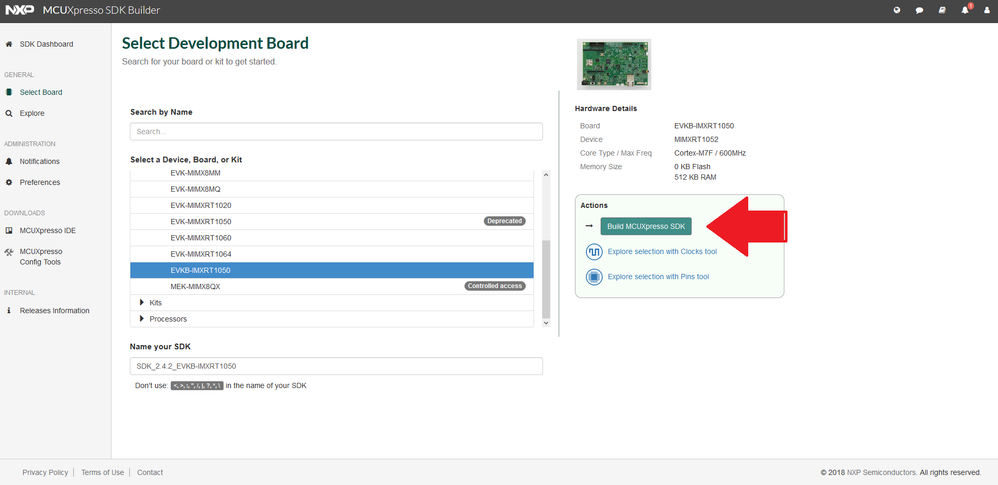

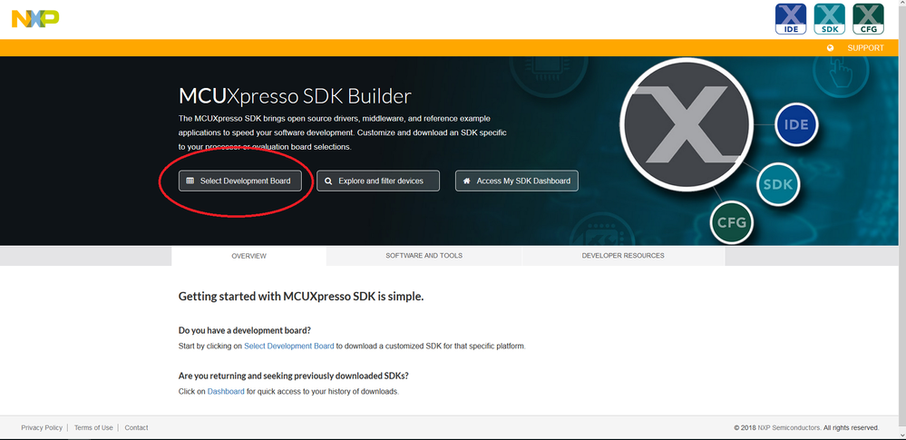

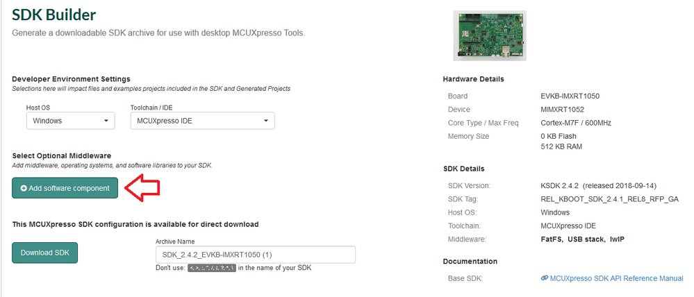

a. In the SDK Builder web page, you can customize and download the specific SDK of your board.
b. On the next page, you can select different OS and different IDE. Select "MCUpresso IDE" for Windows here.
c. You can add the software component that you wanted.
d. Request to build the SDK.

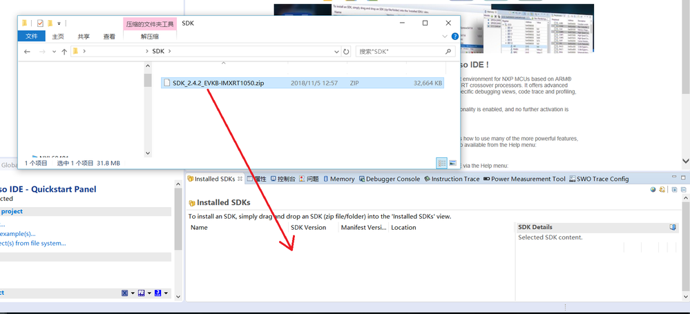

a. Open the MCUXpresso IDE. Simply drag & drop the SDK zip file to "Installed SDKs" view.

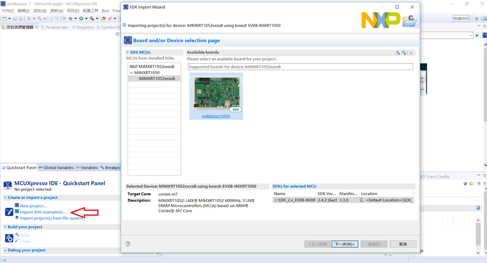

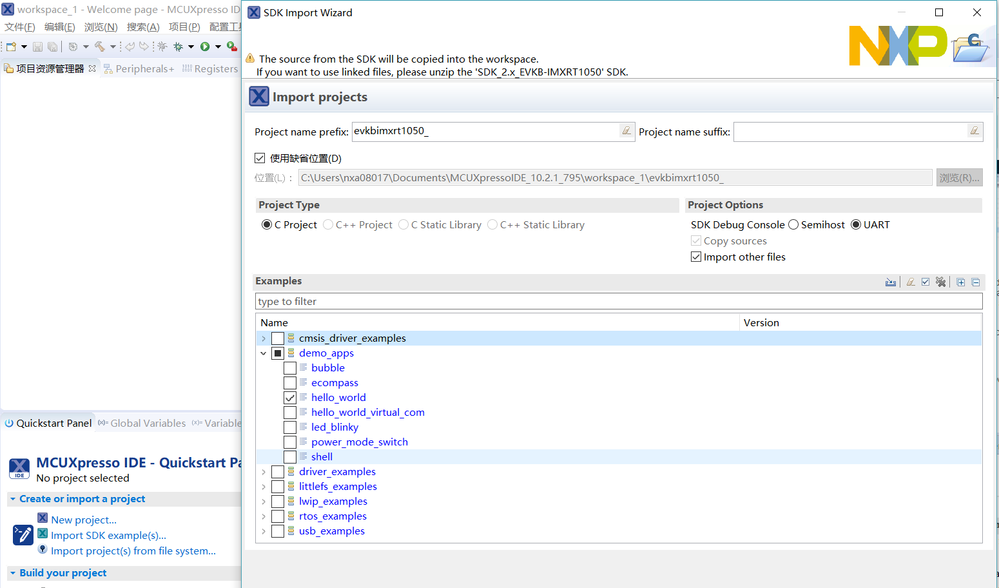

b. Import the SDK examples and then click "Next".
c. Select the "hello_world" under the demo_apps.

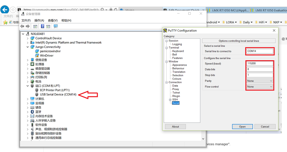

e. Execute the terminal software (e.g. PuTTY). The COM port of the console output can be found in "devices manager". The COM setting is 115200,8,N,1.

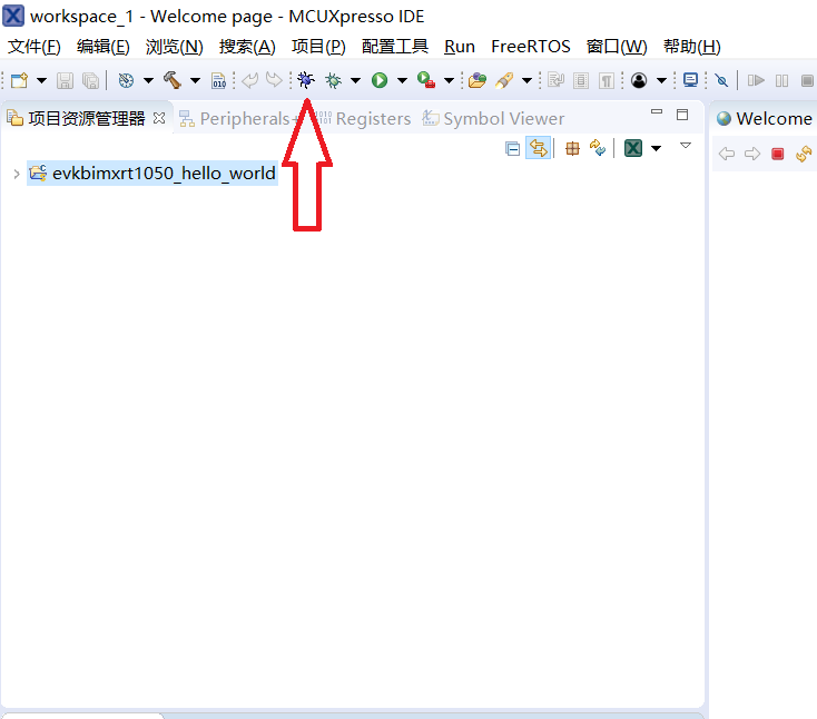

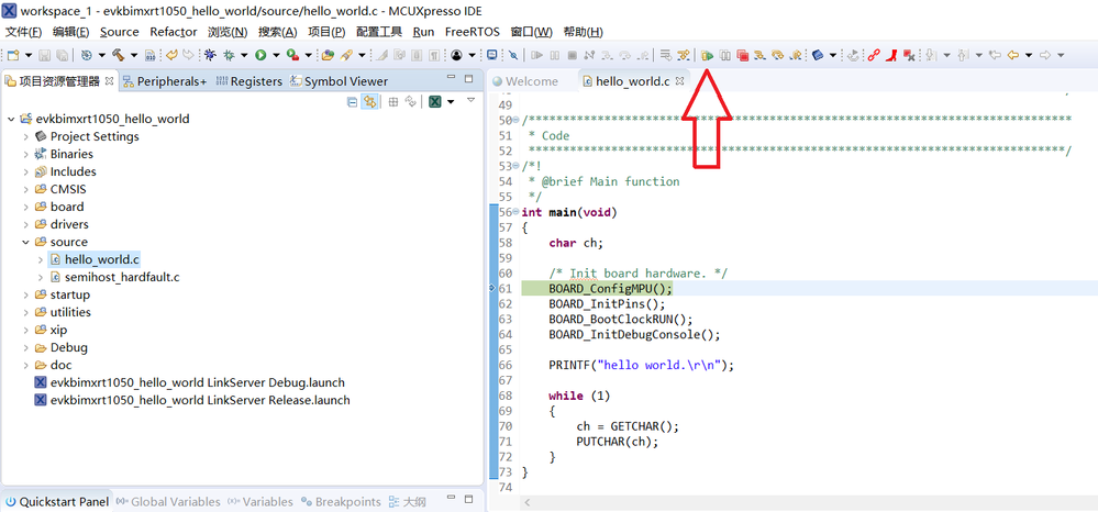

f. Click the "bug" icon to start the debugging.
g. Click "Resume All Debug Sessions" icon to run the demo.

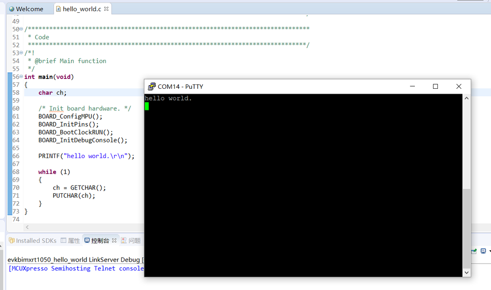

h. "hello world" print out in console.
