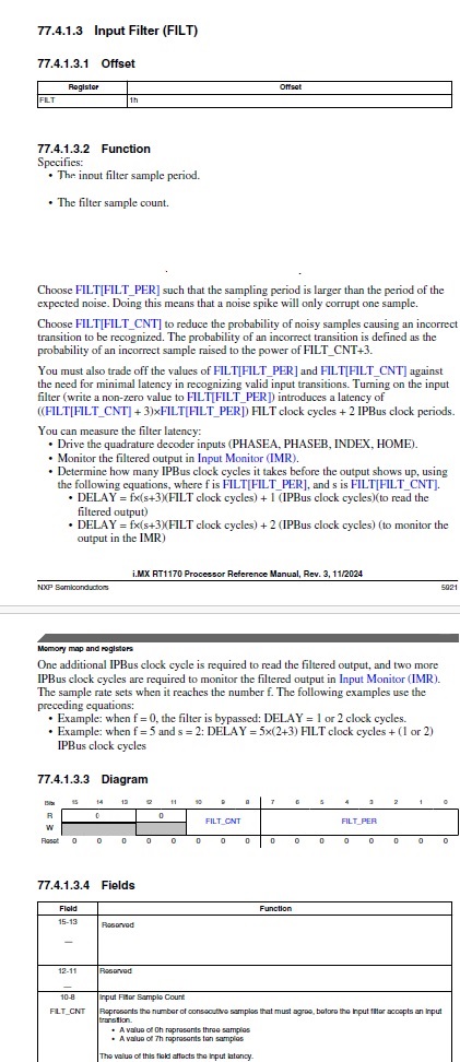

The table below contains notable updates to the current release of the Reference Manual. The information provided here is preliminary and subject to change without notice.
Affected Modules Issue Summary Description Date
QDC Incorrect Input Filter Register (FILT) configuration.  FILT_PRSC bitfield is not implemented in Design. 22 May 2025
