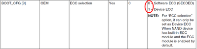

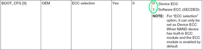

System Boot Incorrect encoding for BOOT_CFG[9] - ECC Selection
The encoding for the boot configuration bit for the ECC selection is incorrect. Device ECC should be 0 and Software ECC should be 1.
Before:
After:
