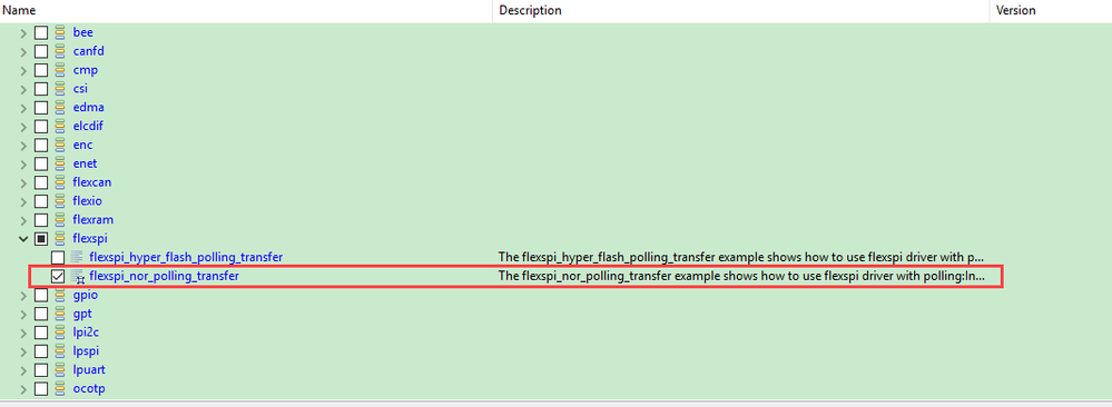

Importing the SDK example
The RT1064-EVK comes with two external flash memories, 512 Mb Hyper Flash and 64 Mb QSPI Flash. The RT1064-SDK includes two example projects that demonstrate how to use any of these two external flash memories as NVM. In this document, we will take as a base one of these examples to modify it to use the on-chip flash as NVM.
Once you downloaded and imported the SDK into MCUXpresso IDE, you will need to import the example flexspi_nor_polling_transfer into your workspace.
