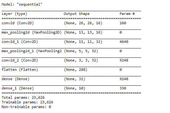

The below code will define and run it will show the struct of the model.
# Define a Model
model =  tf.keras.models.Sequential()
# First Convolution ,Kernel:16*3*3
model.add( tf.keras.layers.Conv2D(16, (3, 3), activation='relu', kernel_initializer='he_uniform',input_shape=(28, 28, 1)))
model.add( tf.keras.layers.MaxPooling2D((2, 2)))
# Second Convolution ,Kernel:32*3*3
model.add( tf.keras.layers.Conv2D(32, (3, 3), activation='relu',kernel_initializer='he_uniform'))
# Third Convolution ,Kernel:32*3*3
model.add( tf.keras.layers.Flatten())
model.add( tf.keras.layers.Dense(32, activation='relu',kernel_initializer='he_uniform'))
model.add( tf.keras.layers.Dense(10, activation='softmax'))
2020-09-28_10-47-15.pngFig 4

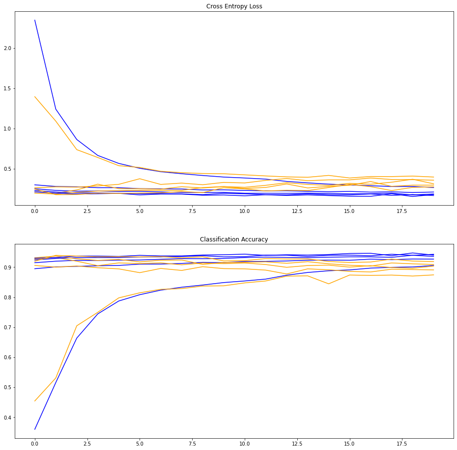

After the model has been trained, we can present the results.
There are two key aspects to present: the diagnostics of the learning behavior of the model during training and the estimation of the model performance. These can be implemented using separate functions.
First, the diagnostics involve creating a line plot showing model performance on the train and validate set during each fold of the k-fold cross-validation. These plots are valuable for getting an idea of whether a model is overfitting, underfitting, or has a good fit for the dataset.
We will create a single figure with two subplots, one for loss and one for accuracy. Blue lines will indicate model performance on the training dataset and orange lines will indicate performance on the hold-out validate dataset. The summarize_diagnostics() function below creates and shows this plot given the collected training histories.
# plot diagnostic learning curves
def summarize_diagnostics(histories):
    for i in range(len(histories)):
        # plot loss
        plt.subplot(2,1,1)
        plt.title('Cross Entropy Loss')
        plt.plot(histories[i].history['loss'], color='blue', label='train')
        plt.plot(histories[i].history['val_loss'], color='orange', label='test')
        # plot accuracy
        plt.subplot(2,1,2)
        plt.title('Classification Accuracy')
        plt.plot(histories[i].history['accuracy'], color='blue', label='train')
        plt.plot(histories[i].history['val_accuracy'], color='orange', label='test')
    plt.show()
Fig 5

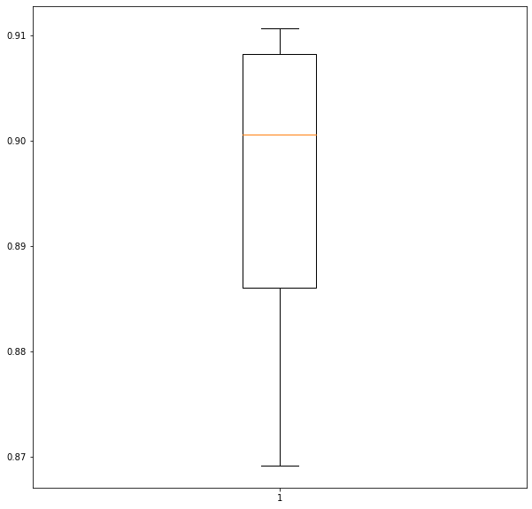

Next, the classification accuracy scores collected during each fold can be summarized by calculating the mean and standard deviation. This provides an estimate of the average expected performance of the model trained on the test dataset, with an estimate of the average variance in the mean. We will also summarize the distribution of scores by creating and showing a box and whisker plot.
The summarize_performance() function below implements this for a given list of scores collected during model training.
# summarize model performance
def summarize_performance(scores):
    # print summary
    print('Accuracy: mean={:.4f} std={:.4f}, n={:0>2d}'.format(np.mean(trained_scores)*100, np.std(trained_scores)*100, len(scores)))
    # box and whisker plots of results
    plt.boxplot(scores)
    plt.show()
Fig 6

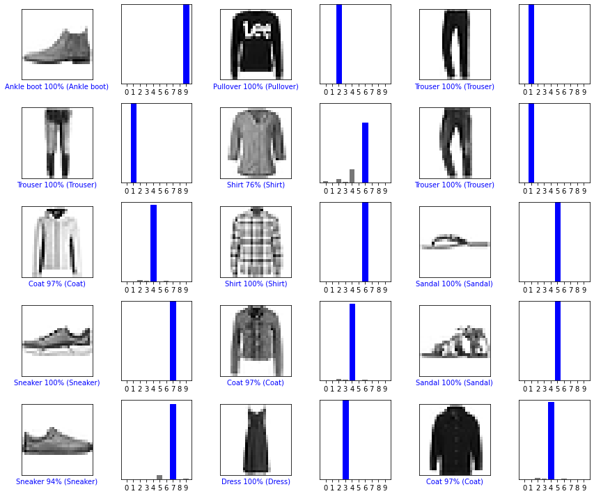

Verifying predictions
According to the above figure, we see that the final trained model can get up to around 87.6% accuracy when predicting the test dataset.
And with the trained model, running the below code will demonstrate the result of predictions about some images.
def plot_image(i, predictions_array, true_label, img):
  true_label, img = true_label[i], img[i]
  plt.grid(False)
  plt.xticks([])
  plt.yticks([])
  plt.imshow(img.reshape(28, 28), cmap=plt.cm.binary)
  predicted_label = np.argmax(predictions_array)
  if predicted_label == true_label:
    color = 'blue'
  else:
    color = 'red'
  plt.xlabel("{} {:2.0f}% ({})".format(class_names[predicted_label],
                                100*np.max(predictions_array),
                                class_names[true_label]),
                                color=color)
def plot_value_array(i, predictions_array, true_label):
  true_label = true_label[i]
  plt.grid(False)
  plt.xticks(range(10))
  plt.yticks([])
  thisplot = plt.bar(range(10), predictions_array, color="#777777")
  plt.ylim([0, 1])
  thisplot[predicted_label].set_color('red')
  thisplot[true_label].set_color('blue')
  predictions = model.predict(test_images)
# Plot the first X test images, their predicted labels, and the true labels.
# Color correct predictions in blue and incorrect predictions in red.
num_rows = 5
num_cols = 3
num_images = num_rows*num_cols
plt.figure(figsize=(2*2*num_cols, 2*num_rows))
for i in range(num_images):
  plt.subplot(num_rows, 2*num_cols, 2*i+1)
  plot_image(i, predictions[i], test_labels, test_images)
  plt.subplot(num_rows, 2*num_cols, 2*i+2)
  plot_value_array(i, predictions[i], test_labels)
plt.tight_layout()
plt.show()
Fig 7

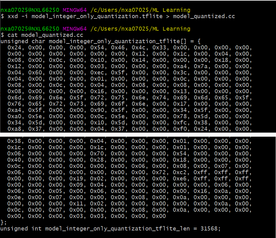

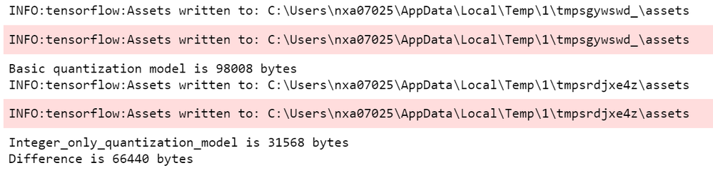

Model quantization
Post-training quantization is a conversion technique that can reduce model size while also improving CPU and hardware accelerator latency, with little degradation in model accuracy, especially it's crucial to embedded platforms, as it lacks the compute-intensive performance, the Flash and RAM memory is also very limited.
TensorFlow Lite is able to be used to convert an already-trained float TensorFlow model to the TensorFlow Lite format. In addition, the TensorFlow Lite provides several approaches to optimize the mode, among these ways, Integer quantization is an optimization strategy that converts 32-bit floating-point numbers (such as weights and activation outputs) to the nearest 8-bit fixed-point numbers. This results in a smaller model and increased inferencing speed, which is very valuable for low-power devices such as microcontrollers.
The below codes show how to implement the Integer quantization of the trained model, and after running these codes, we can find that the size of Tensorflow Lite mode reduces almost 64.9 KB versus the original model, becomes about 32% of the original size(Fig 8).
import os
# Convert using integer-only quantization
def representative_data_gen():
  for input_value in tf.data.Dataset.from_tensor_slices(tf.cast(train_images,tf.float32)).shuffle(500).batch(1).take(150):
    yield [input_value]
# Convert using dynamic range quantization
converter = tf.lite.TFLiteConverter.from_keras_model(model)
converter.optimizations = [tf.lite.Optimize.DEFAULT]
tflite_model_quant = converter.convert()
# Save the model to disk
open("model_dynamic_range_quantization.tflite", "wb").write(tflite_model_quant)
## Size difference
Dynamic_range_quantization_model_size = os.path.getsize("model_dynamic_range_quantization.tflite")
print("Dynamic range quantization model is %d bytes" % Dynamic_range_quantization_model_size)
converter.representative_dataset = representative_data_gen
# Ensure that if any ops can't be quantized, the converter throws an error
converter.target_spec.supported_ops = [tf.lite.OpsSet.TFLITE_BUILTINS_INT8]
# Set the input and output tensors to uint8 (APIs added in r2.3)
converter.inference_input_type = tf.uint8
converter.inference_output_type = tf.uint8
tflite_model_advanced_quant = converter.convert()
open("model_integer_only_quantization.tflite", "wb").write(tflite_model_advanced_quant)
Integer_only_quantization_model_size = os.path.getsize("model_integer_only_quantization.tflite")
print("Integer_only_quantization_model is %d bytes" % Integer_only_quantization_model_size)
difference = Dynamic_range_quantization_model_size - Integer_only_quantization_model_size
print("Difference is %d bytes" % difference)
Fig 8

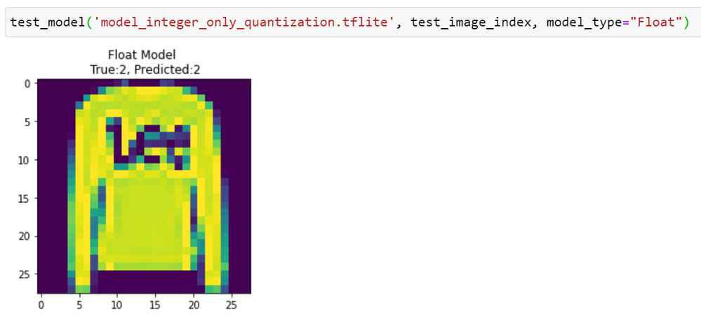

Evaluating the TensorFlow Lite model
Now we'll run inferences using the TensorFlow Lite Interpreter to compare the model accuracies.
First, we need a function that runs inference with a given model and images, and then returns the predictions:
# Helper function to run inference on a TFLite model
def run_tflite_model(tflite_file, test_image_indices):
  # Initialize the interpreter
  interpreter = tf.lite.Interpreter(model_path=str(tflite_file))
  interpreter.allocate_tensors()
  input_details = interpreter.get_input_details()[0]
  output_details = interpreter.get_output_details()[0]
  predictions = np.zeros((len(test_image_indices),), dtype=int)
  for i, test_image_index in enumerate(test_image_indices):
    test_image = test_images[test_image_index]
    test_label = test_labels[test_image_index]

Next, we'll compare the performance of the original model and the quantized model on one image.
  • model_basic_quantization.tflite is the original TensorFlow Lite model with floating-point data.
  • model_integer_only_quantization.tflite is the last model we converted using integer-only quantization (it uses uint8 data for input and output).
Let's create another function to print our predictions and run it for testing.
import matplotlib.pylab as plt
# Change this to test a different image
test_image_index = 1
## Helper function to test the models on one image
def test_model(tflite_file, test_image_index, model_type):
  global test_labels
  predictions = run_tflite_model(tflite_file, [test_image_index])
  plt.imshow(test_images[test_image_index].reshape(28,28))
  template = model_type + " Model \n True:{true}, Predicted:{predict}"
  _ = plt.title(template.format(true= str(test_labels[test_image_index]), predict=str(predictions[0])))
  plt.grid(False)
Fig 9
Fig 10
Then evaluate the quantized model by using all the test images we loaded at the beginning of this tutorial.
After summarizing the prediction result of the test dataset, we can see that the prediction accuracy of the quantized model decrease 7% less than the original model, it's not bad.

Deploying model
  • Converting TensorFlow Lite model to C file
The following code runs xxd on the quantized model, writes the output to a file called model_quantized.cc, in the file, the model is defined as an array of bytes, and prints it to the screen. The output is very long, so we won’t reproduce it all here, but here’s a snippet that includes just the beginning and end.
# Save the file as a C source file
xxd -i model_integer_only_quantization.tflite > model_quantized.cc
# Print the source file
cat model_quantized.cc
Fig 11

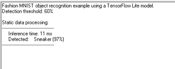

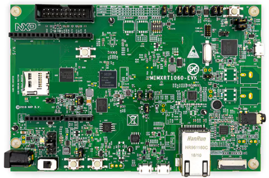

  • Testing result
After deploying the model in the demo project, then we'll run this demo on the MIMXRT1060 (Fig 12) board for testing.
Fig 12
