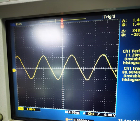

For example we want to get 88Mhz output via SYS PLL clock. We can follow the steps as the below(led_blinky project in SDK ):
      1. PINMUX GPIO_SD_B0_04 as CCM_CLKO1 signal.
      IOMUXC_SetPinConfig(
      IOMUXC_GPIO_SD_B0_04_CCM_CLKO1,
      0x10B0u;
2.Enable CCM_CLKO1 signal.
CCM->CCOSR |= CCM_CCOSR_CLKO1_EN_MASK;
3.Set CLKO1_DIV to get 88MHZ the clock for the application.
CCM->CCOSR = (CCM->CCOSR & (~CCM_CCOSR_CLKO1_DIV_MASK)) | CCM_CCOSR_CLKO1_DIV(2); CCM->CCOSR = (CCM->CCOSR & (~CCM_CCOSR_CLKO1_SEL_MASK)) | CCM_CCOSR_CLKO1_SEL(1);
  • 4 We will get the clock as the below.
  • Note: In principle, it is not recommended to output CLOCK in CCM_CLKO1, if necessary, Please connect an 8-10pf capacitor to GPIO_SD_B0_04, and connect a 22 ohm resistor in series to prevent interference.
